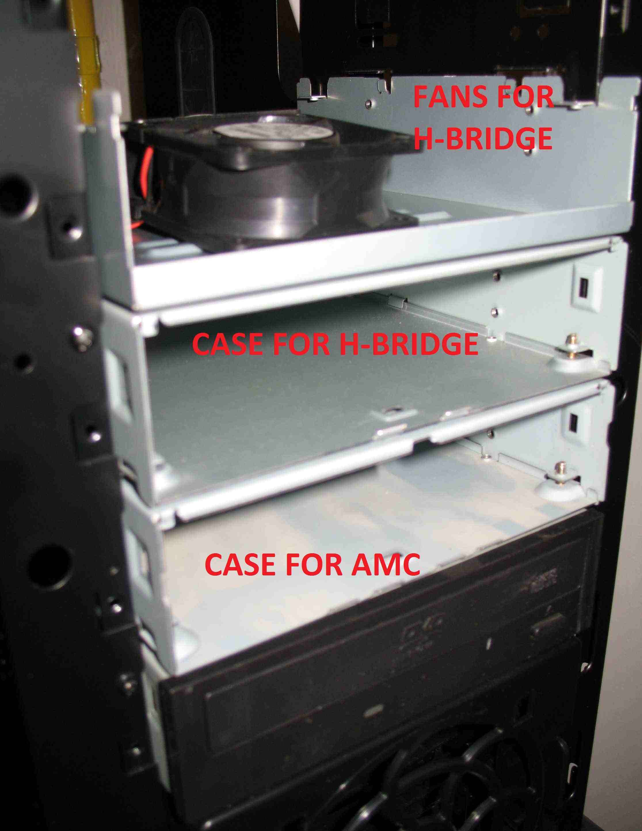

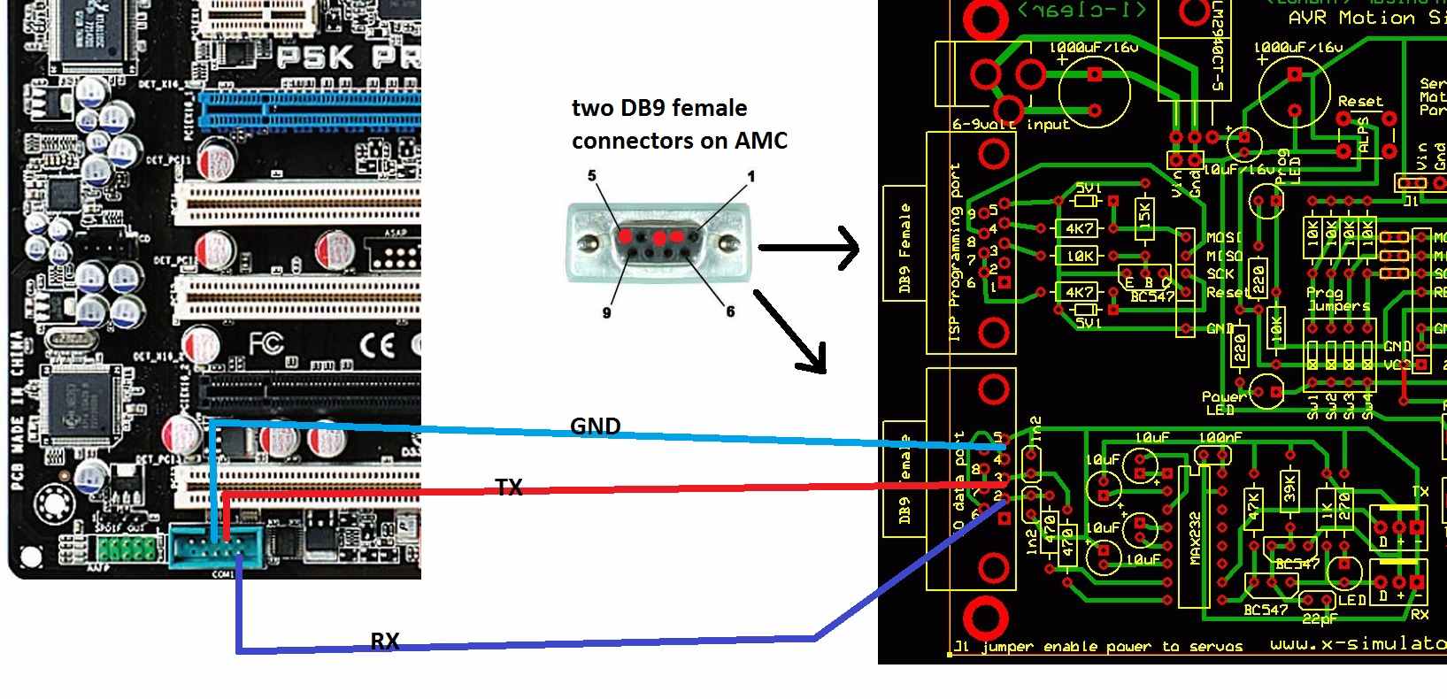

    I dont know on what connection you mind...I was make some sketch
    how I was connect AMC board with my motherboard and simulator .
    All work OK and KP settings with terminal also work OK
    For programming ATmega I use standard serial cable.
    I did not try use similarly solution with other DB9 programming port, but
    once is ATMEGA is programmed, you dont need that port....
    My intend is to put AMC board and Hbride in my PC case.
    So, I was disassemble tree old CDs and I will install inside AMC borad, h-bridhe and
    on a top two FANs and that is reason why I was looking for a solution
    to make all connections simplify
    regards
    igor

    Please note, that you are using the max232 circuit on the original AMC.
    This is not on the ~EZ~ version, instead it uses a serial to usb adapter.
    You could build the max232 circuit on a separate board if you wanted to, and attach it all like in the pic.
    But it would be al lot easier to use the converter.

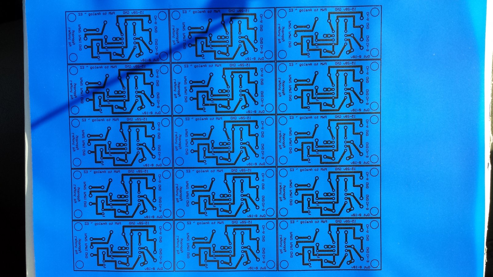

    Happy day, I will be building many of the pwm to analog EZ boards. Please post dimensions for the PCB. Blessing to all, John
  7. yobuddy
    51,704Coins
    +5,204 / 19 / -0
    Hi @MagicEdge The dimensions are in the PDF layout.
    the print is to size. :thumbs

    Yobuddy, when printed at 100% the pcb is tiny. No way a 1/4 watt resistor would fit. At 150 % it may work. Please, could someone give actual size?

    Thanks yobuddy, All worked out and ready to transfer to clad boards for etching.

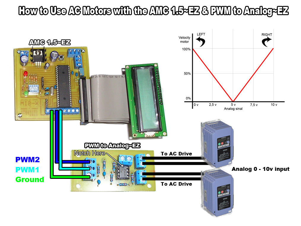

    Guys,I see the pwm wires here connecting to the pwm to analogue convertor,but where are the direction wires?
  19. yobuddy
    51,704Coins
    +5,204 / 19 / -0
    @Llewelyn,
    0v up to 5v left, 5v center, above 5v to 10v is right.
    Take care,

    Okay thanks,so that means the direction wires from the arduino are not needed,just the pwm wire connected to the PWM to analogue convertor and that causes changes in direction from voltage changes 0-10v.
