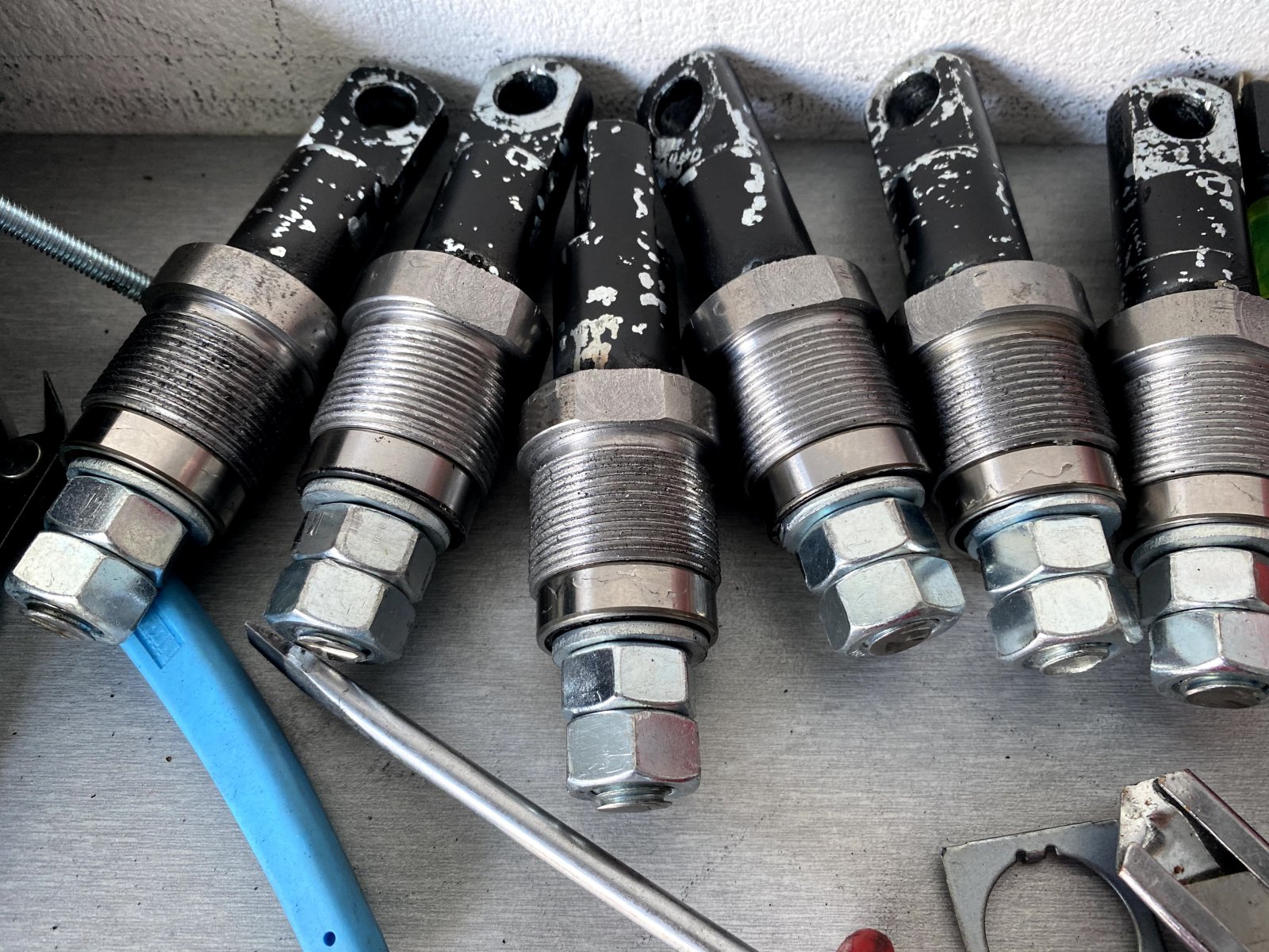

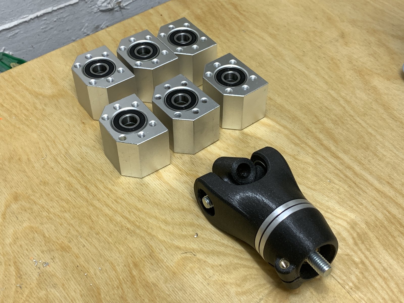

    Bearing itself is not that loud as you can hear on the video and the ballscrew is even less noisy but aluminum enclosure resonates and the work table itself makes it more noisy. One thing i will need to probably exchange is ball nuts as they have plastic ends and one broke off and around 10 balls were inside enclosure. I've managed to assemble it again - we'll see...

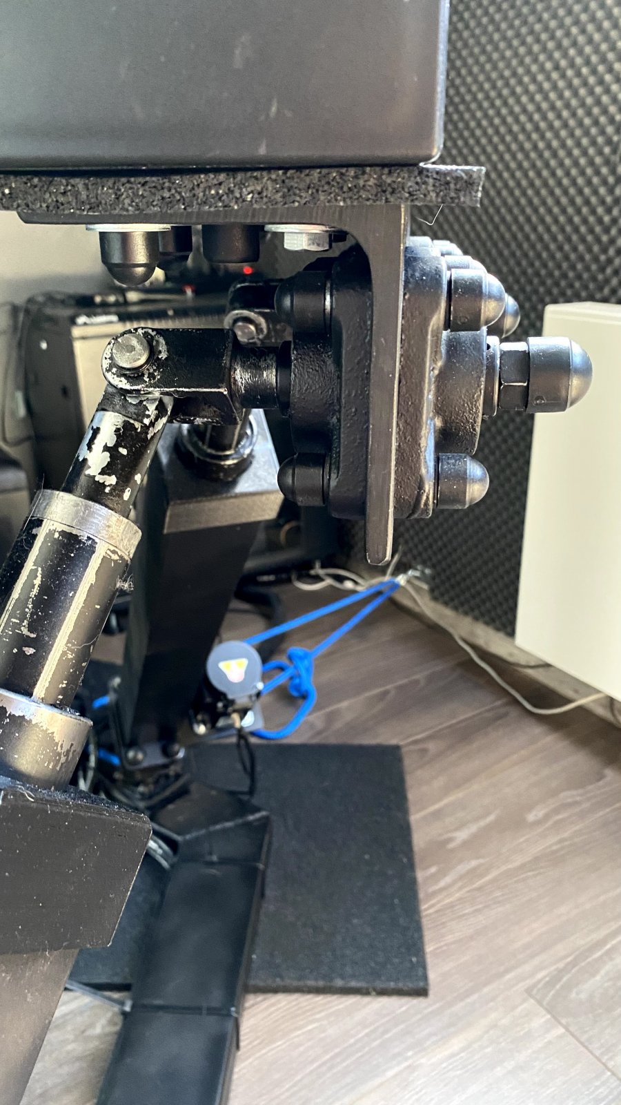

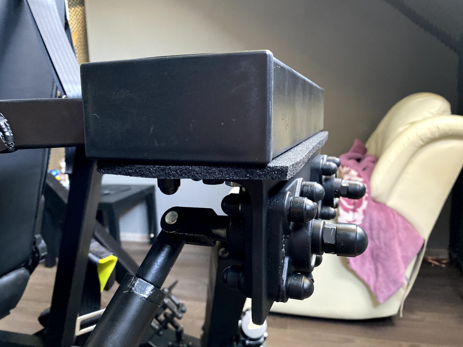

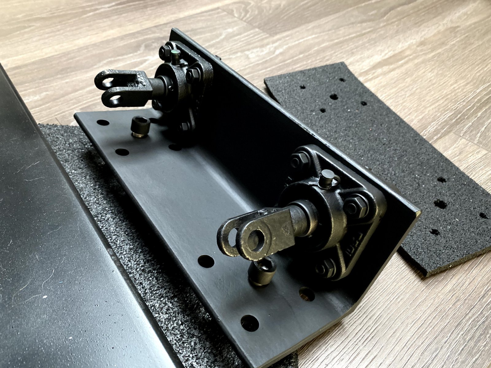

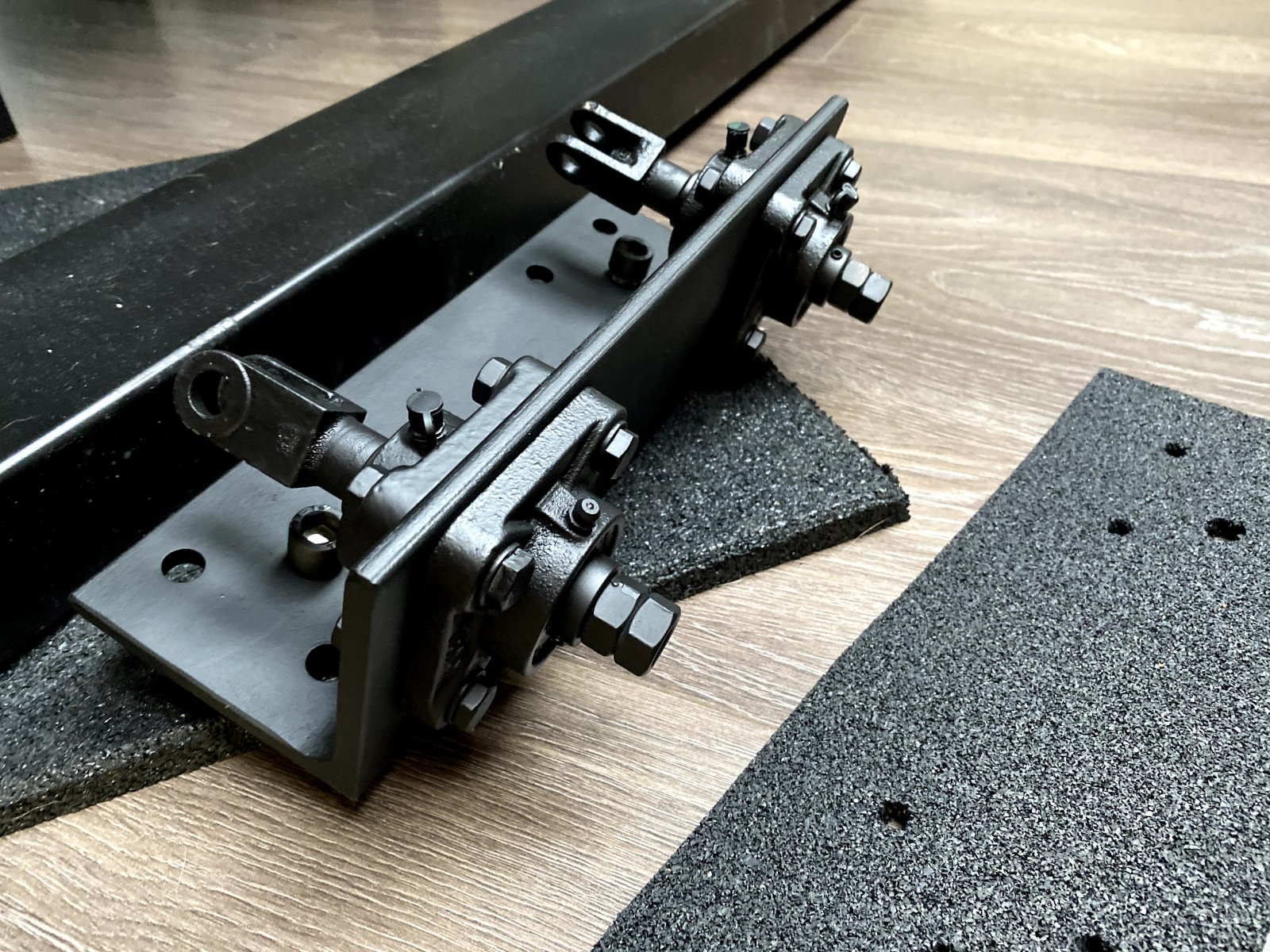

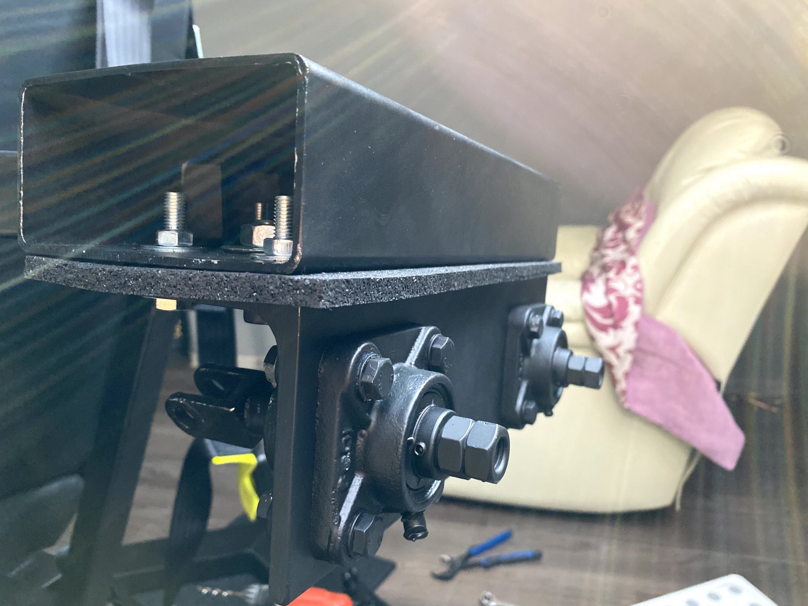

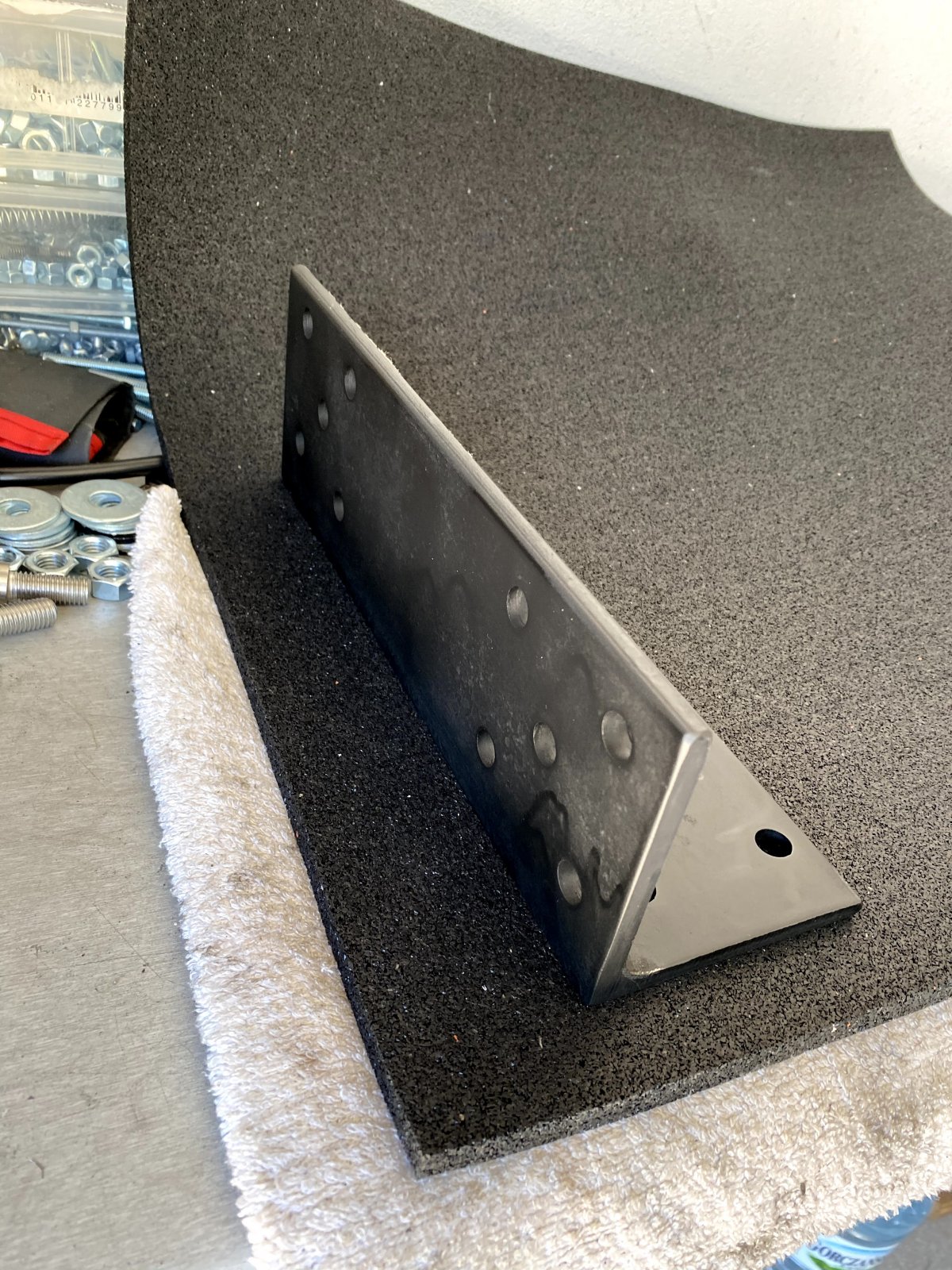

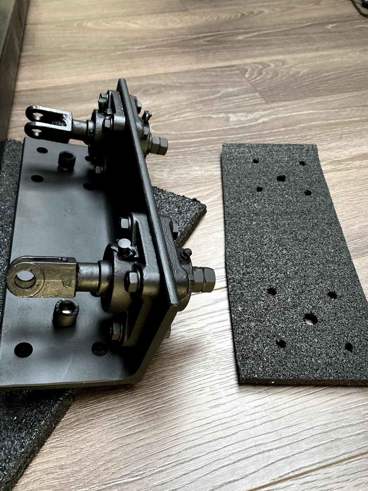

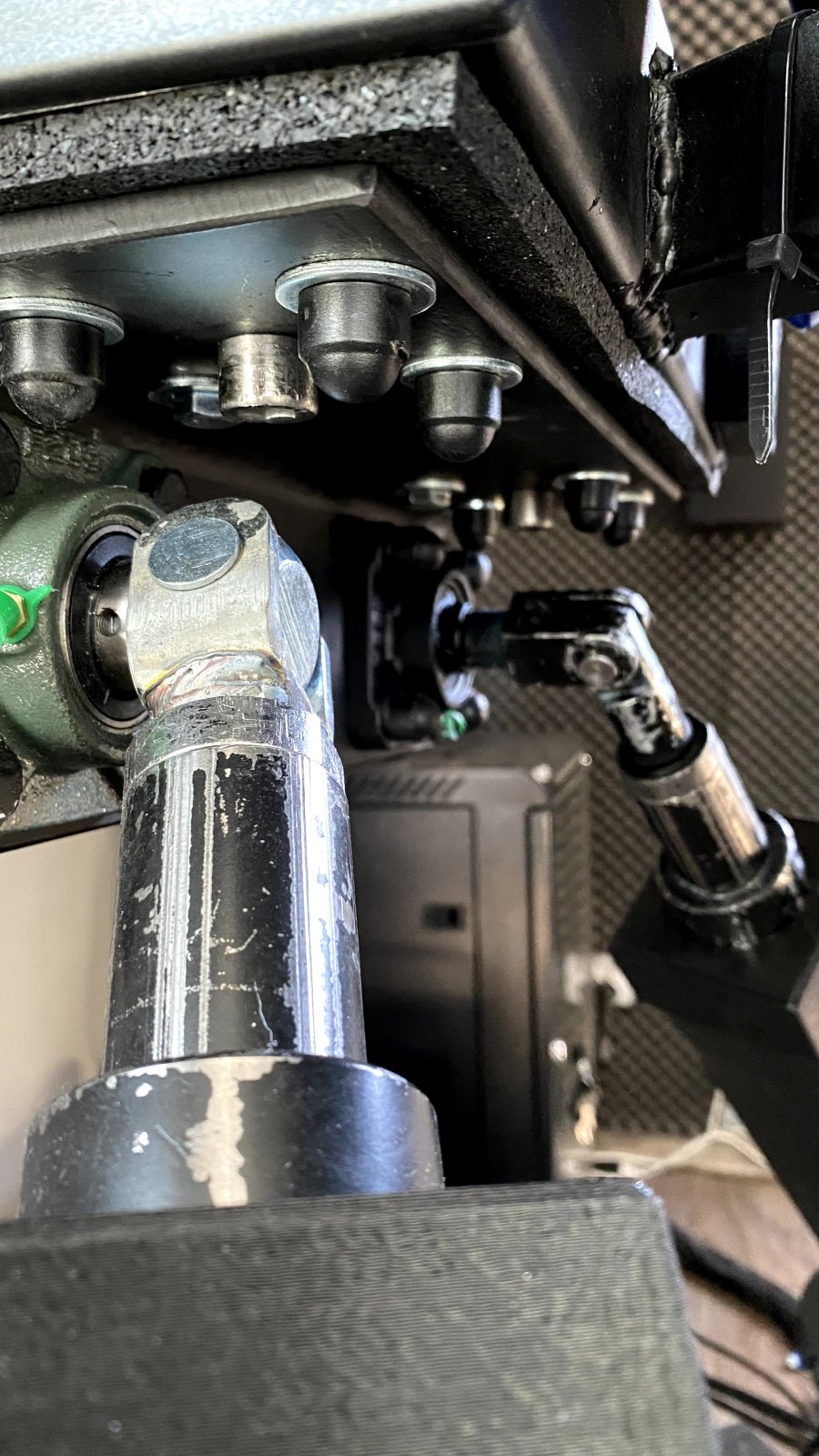

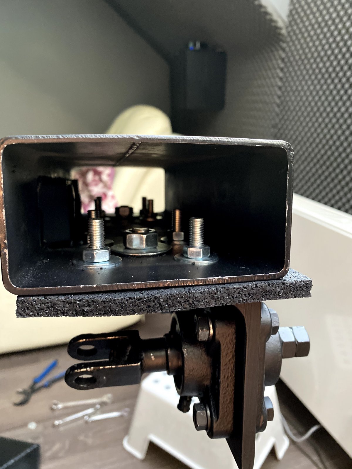

    update on upper mounts. as a bonus - it was very easy to include @Dirty's comment about rubber between upper platform and actuators (10 euro washing machine 600x600x8mm rubber pad from Leroy Merlin). lower platform already stays on 15mm rubber pads:

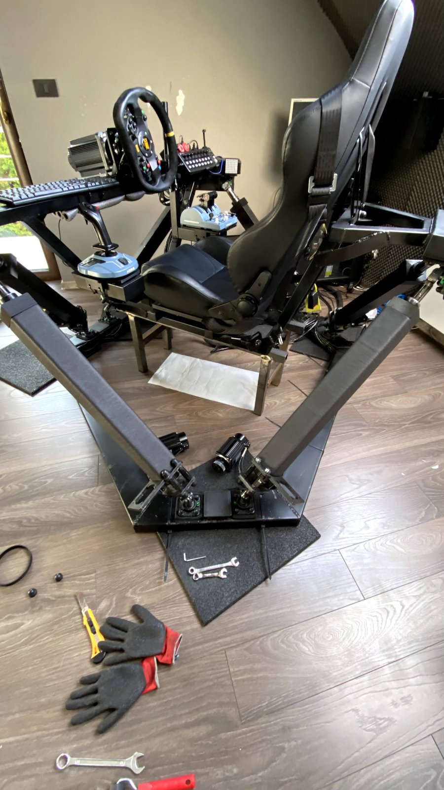

    just when you think it's over...
    i've started moving it by 2 back actuators and i think there's too much play on the joints that makes it quite noisy and shaky...
    take a look (it can be heard rather than seen):
    i already asked my locksmith to manufacture new pins so there is absolutely no play there.
    since i've disassembled it totally i'm thinking about adding this 8mm rubber mat below those bearings that are on the lower platform - should help with silencing as well as some floor shaking.
    @Dirty , what do you think?

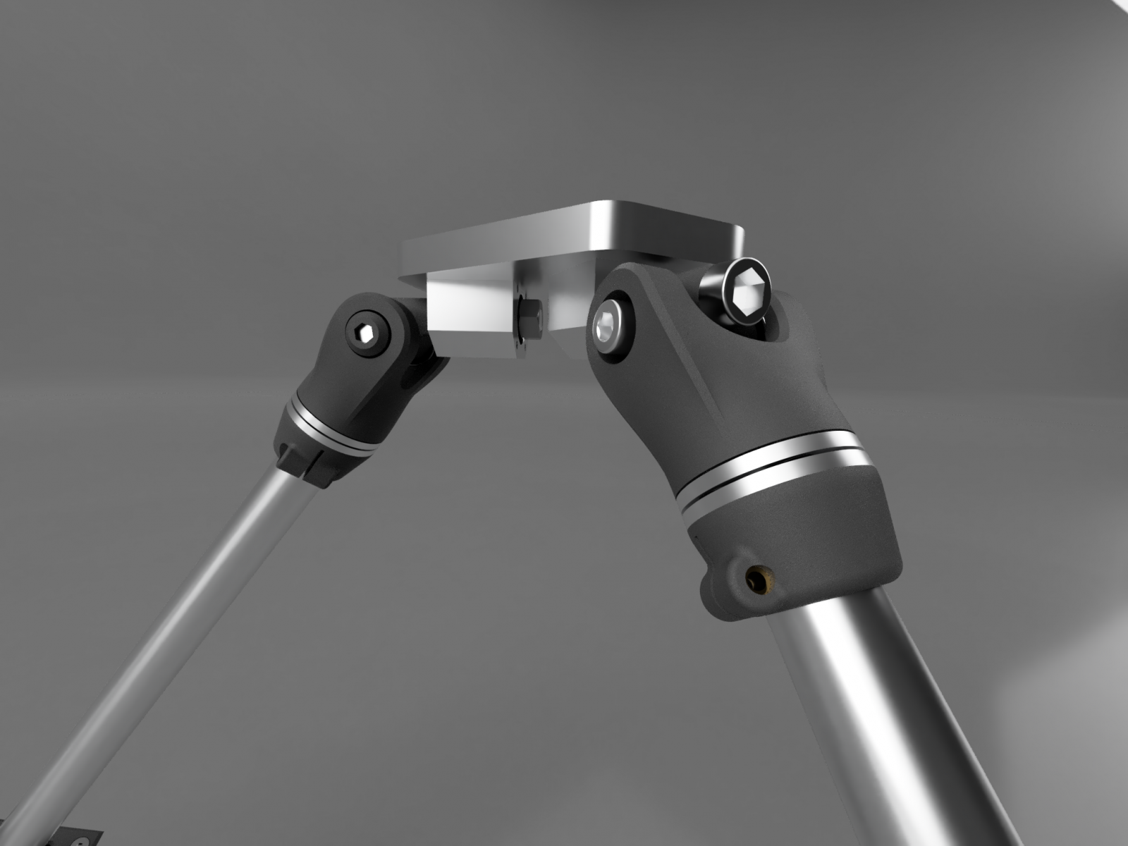

    I think that so many people got quite acceptable results with using "pins in holes" or cheap(-ish) U-joints without ball bearings, that it is safe to assume that you will too :) I have no hands-on experience with this type of U-joint construction though.
    If I remember correctly, I think @PeterW did make some efforts to get his hands on precision pins for his U-joints and those worked absolutely flawlessly. So much so that I was almost going to abandon my own "integrated-all-ball-bearing-mulitaxis-U-joint" development:
    Rig_COnstruction_2020-Mar-03_01-14-26PM-000_CustomizedView3622226751.png Rig_COnstruction_2020-Mar-03_01-57-17PM-000_CustomizedView18111842447_png.png IMG_0333 2.jpeg
    ...which in the end I didn't, and I am very happy with my choice. :)
    In my opinion a rattle-free platform is very important! And a common misconception is that on a 6DOF rig those joints will be under a constant positive load, which is NOT the case. I'd estimate that, even when using the rig for smooth flying, my joints undergo a load direction change once every few seconds. Probably once a second on more action packed types of operation.
    I did build those super smooth U-joints, but if you can achieve a tight tolerance with pins and holes it should get the job done.
    Cheers,...:)

    I'm redesigning those pins so theres no play. You can clearly hear and feel it while actuator moves at higher speed so it has to go. Especially at 500mm/s you can expect negative load.
    My question was actually more about this 8mm rubber mat below the bearing block on bottom platform.

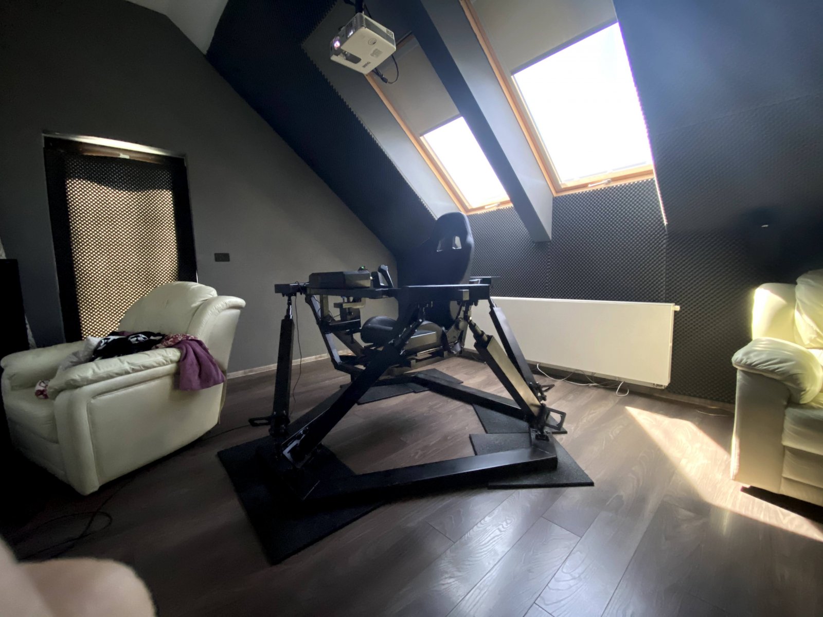

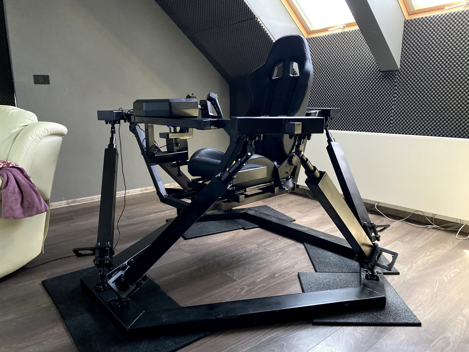

    finally an update. beast is alive! it works extremely well - much better than i expected. initially i had some challenges with tuning FlyPT Mover (@pmvcda ) as i started completely from scratch but then i recalled there are some examples added with this soft and so i took @SilentChill 's settings and started with that. it was a blast! i only had to do very little adjustments to suit my needs. There is still one thing i need to explore when it comes to tuning - i think it can be better tuned for traction loss of RWD cars - i feel well when the car grabs traction back but when it looses it initially it could be felt better (more violently so to speak) so it is caught faster by me. i think "how fast we reach this position" can be increased for starters.
    another thing i need to take care of is squeaking of one of the actuators. i believe i know what is causing it - it's the 3d printed rotation blocking piece that moves on those smaller rods inside actuator. it's very small issue (and only acoustic one) and i'm too happy with the performance of the platform to disassemble it now (i play in headphones anyway).
    one observation that i have is that this kind of stroke/speed combination is completely unusable when it comes to F1 cars - it ends up with jerking back and forth caused by too much force being applied to my body so that i unintentionally move my feet from the brake pedal and then apply it again and so it goes... it has to be tuned down for that type of cars :)
    next items are DD wheel (already got TDD from @Thanos and assembled wheel - just need to buy servomotor) and loadcell pedals (for now i 3d printed them and made it using Hall sensors with lots of rubber on brake pedal - they work surprisingly well).

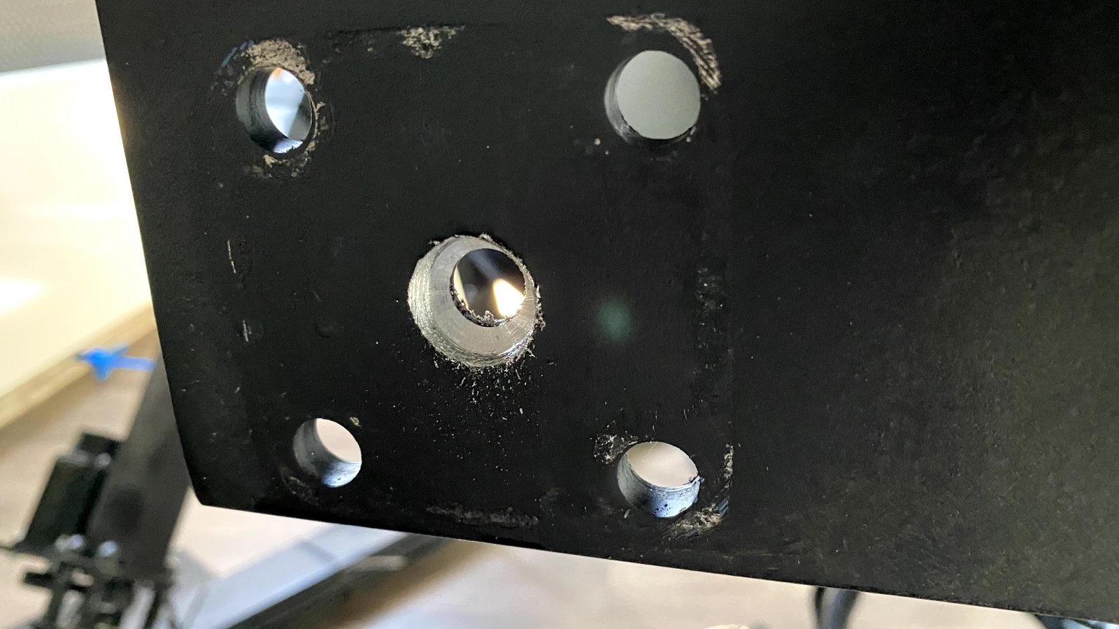

    Update :)

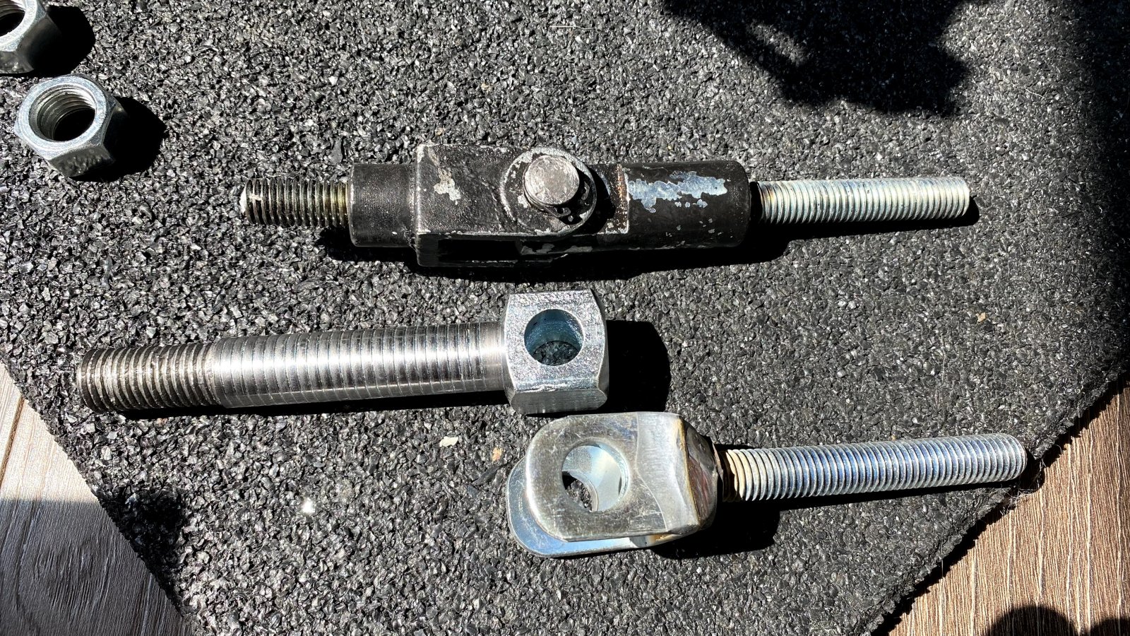

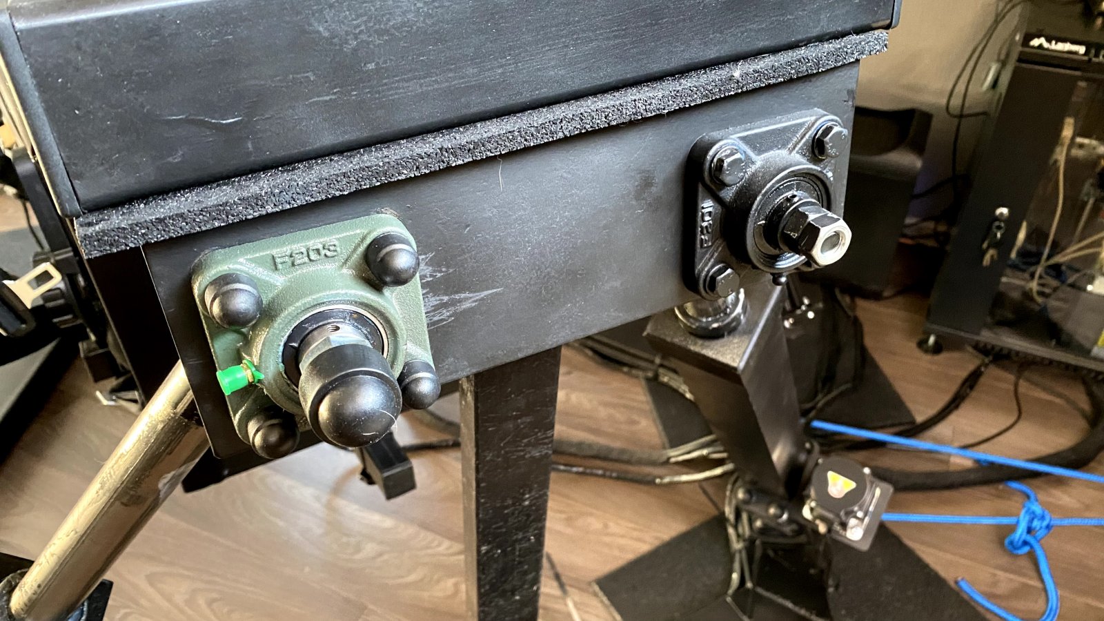

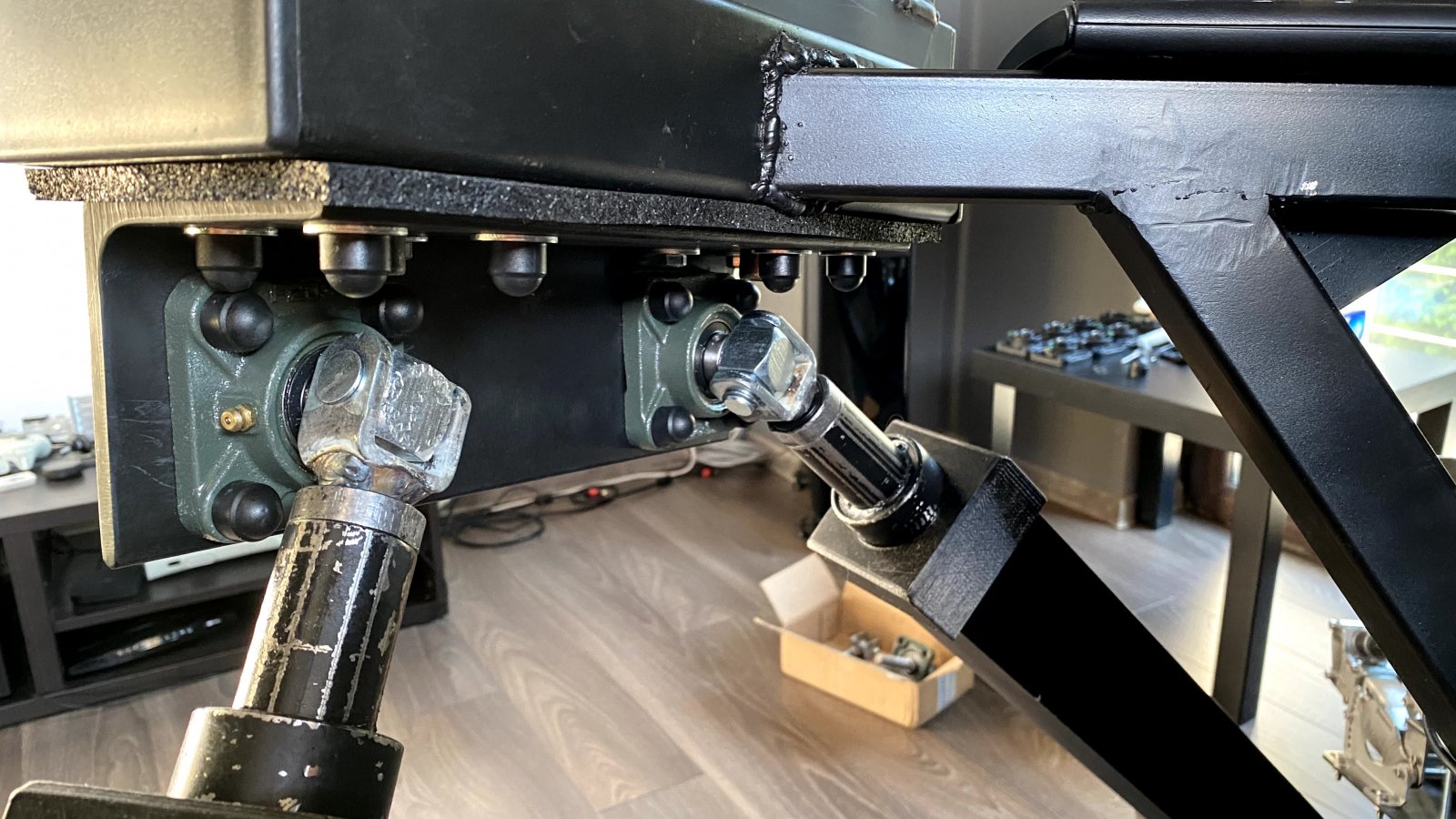

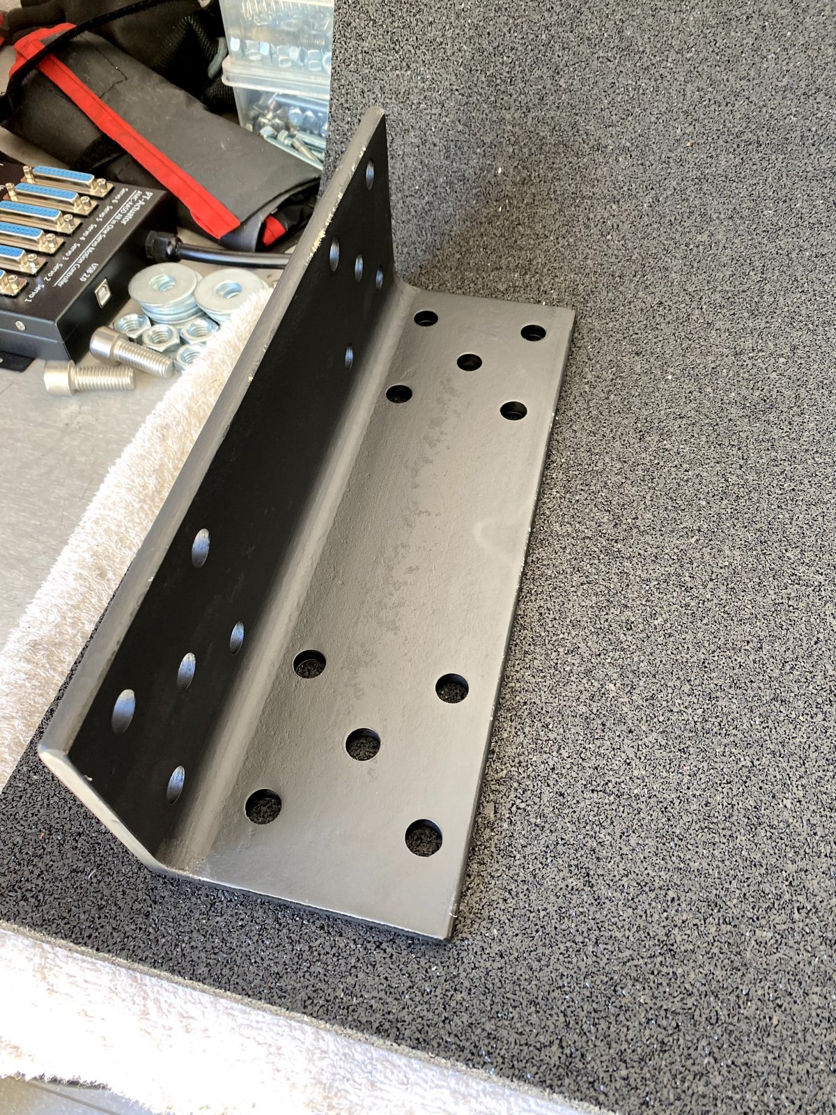

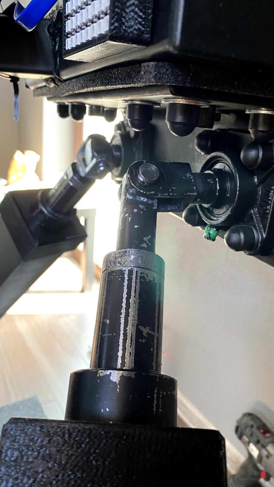

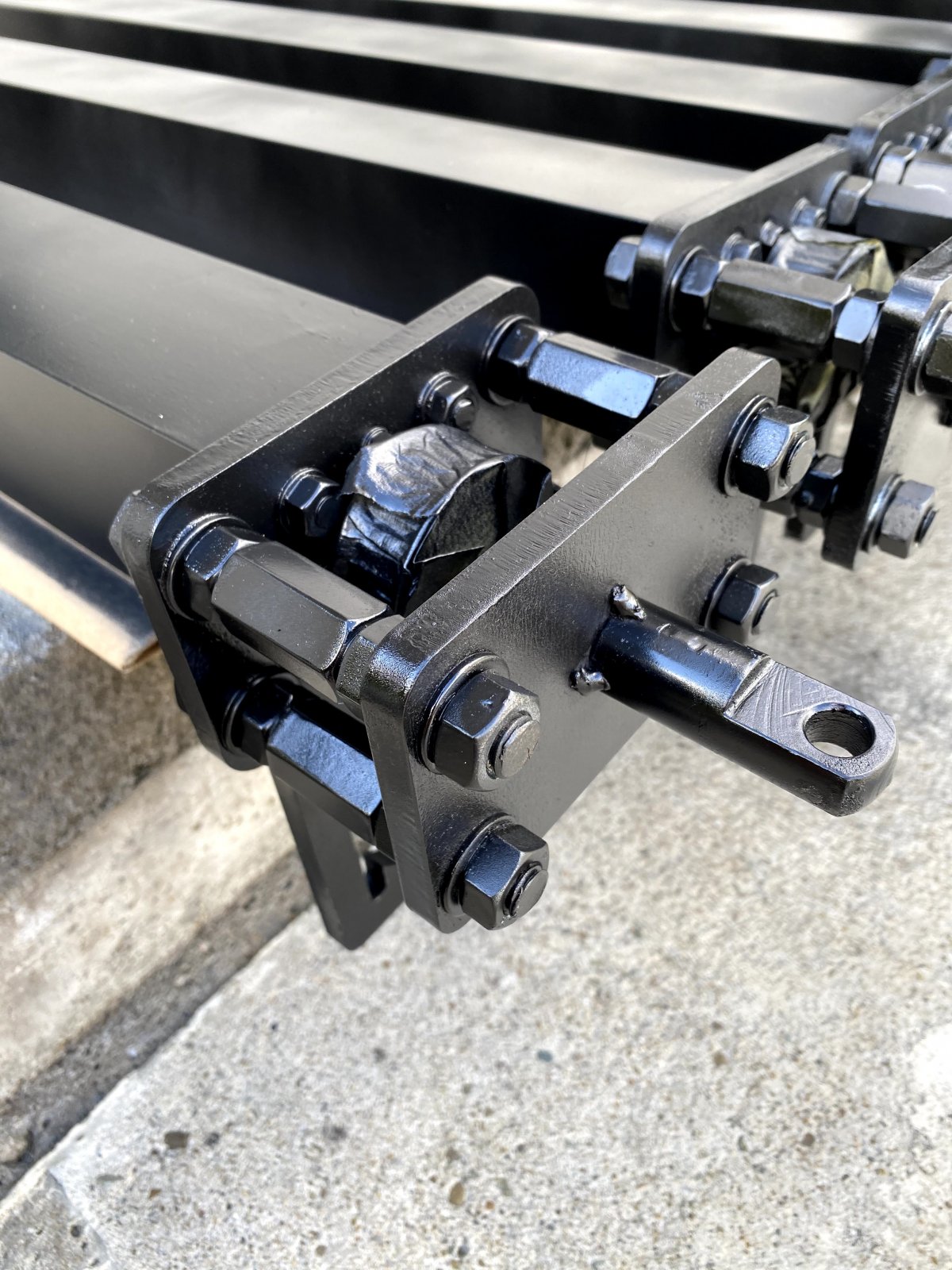

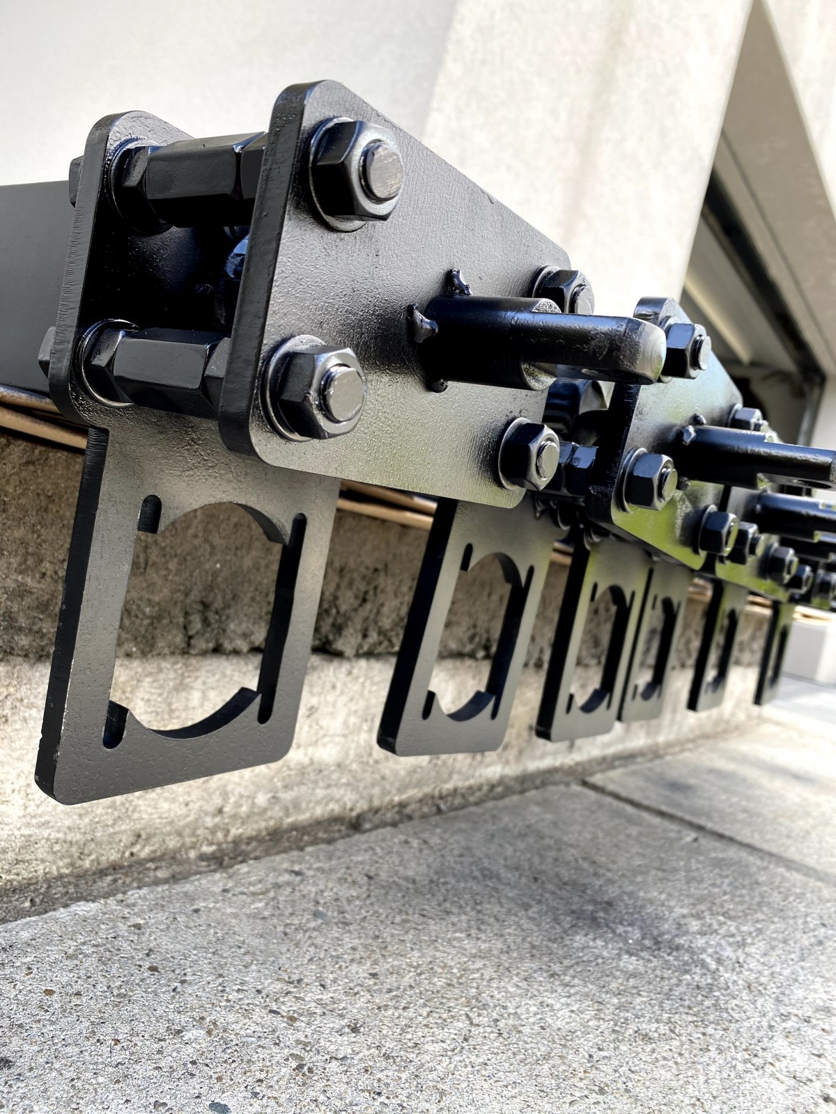

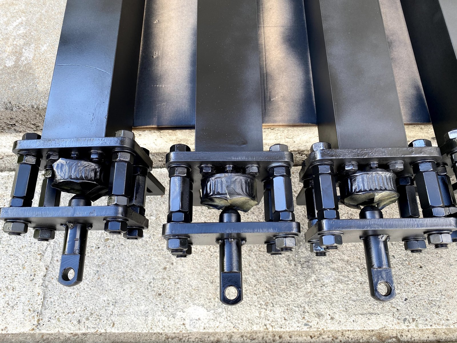

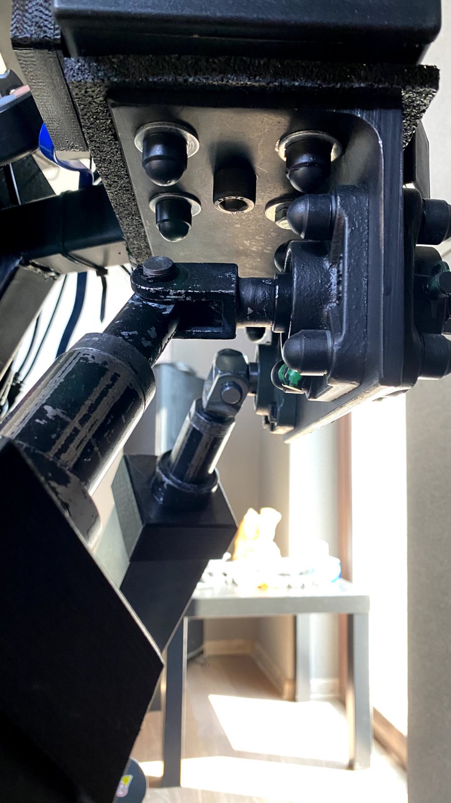

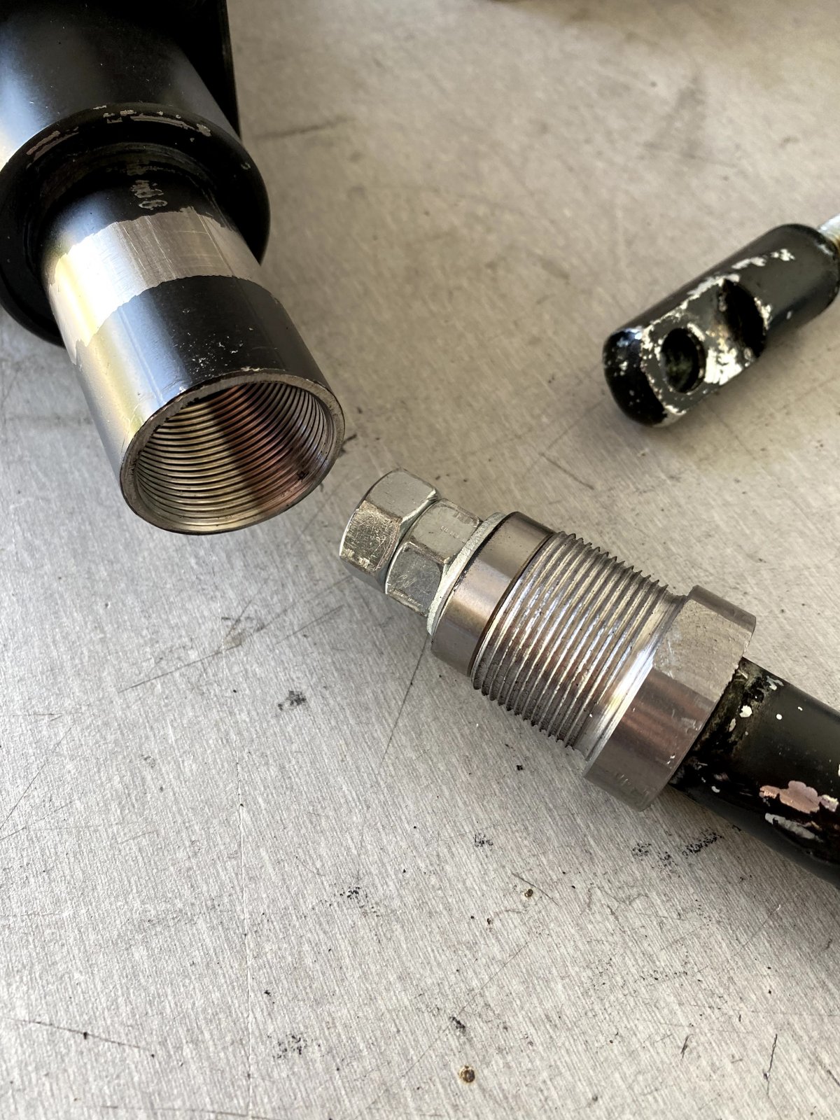

    @Erik Middeldorp you were unfortunately right :) upper mount was bending and finally broke - fortunately in my bare hands when trying to bend it back :)
    i've redesigned it a bit but was kind of limited because of the hole pattern already drilled so i've bought the biggest bearing i could in the same enclosure which is 17mm in diameter. then took outdoor door mounts that are 20mm and cut it down to 17mm (thread basically). it should withstand WW3 now...
    bottom ones are good because there is no almost 90deg angle so the force goes differently.

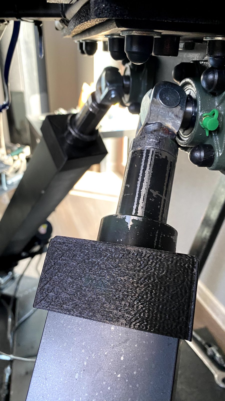

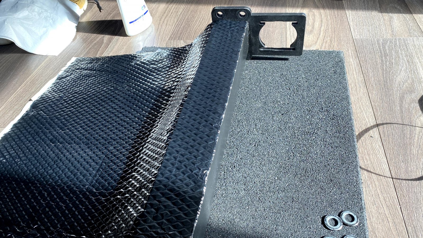

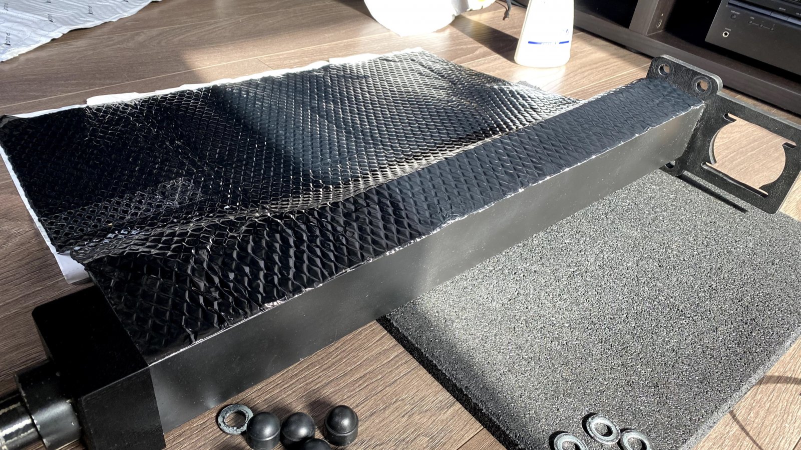

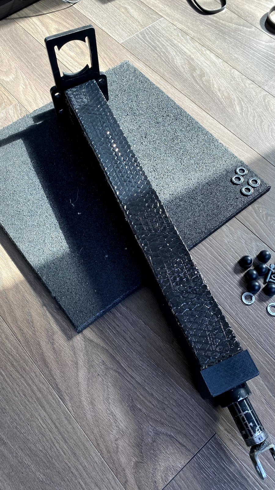

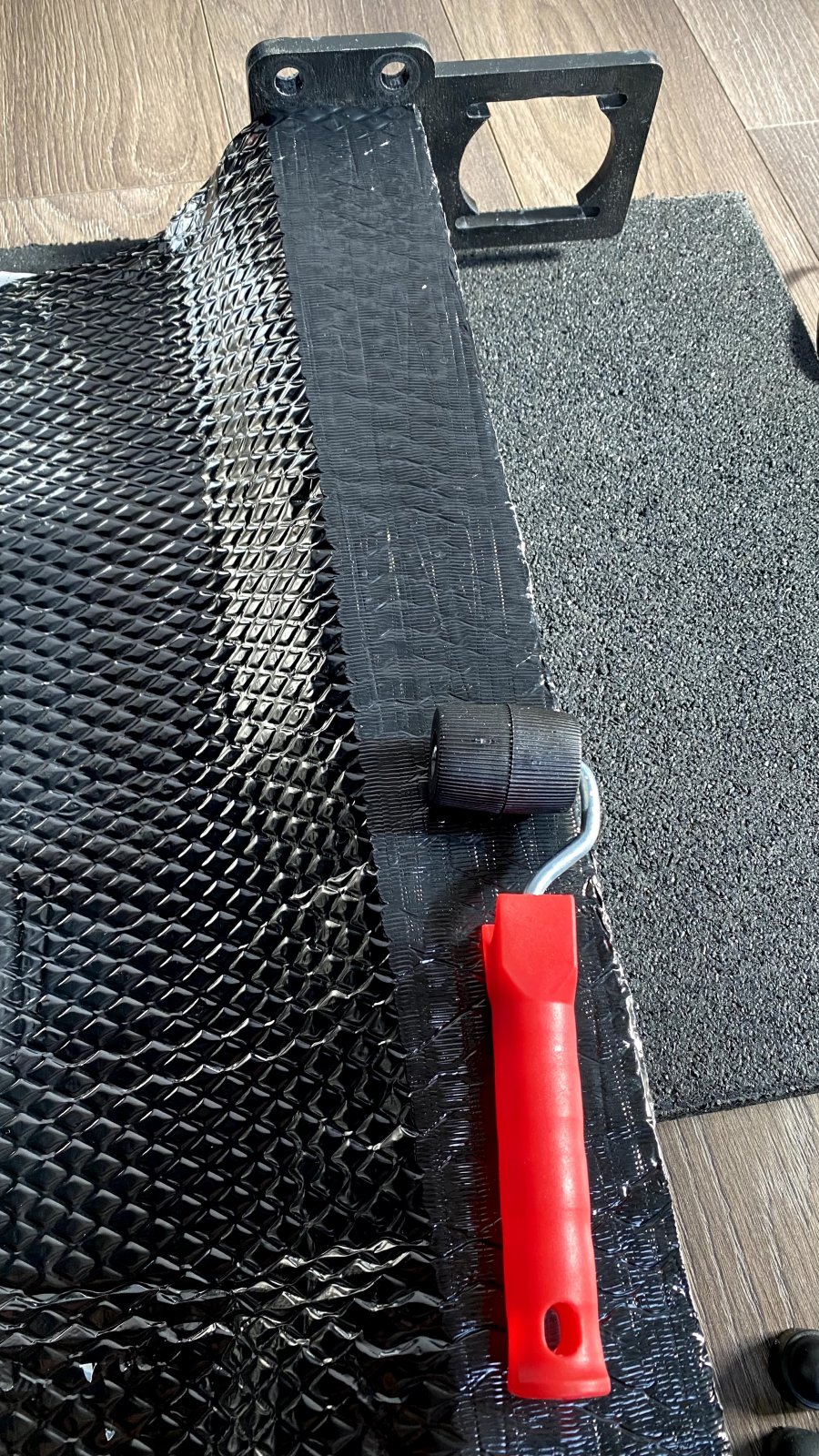

    and on top of that i have another update - silencing of actuators.
    it's a 2mm bituminous mat and then 6mm foam type mat. it's mainly used when silencing cars / doing car audio.

    Ha,.... I saw (heard) exactly this type of sound deadening on @PeterW 's actuators two weeks ago :) Or rather,... I DIDN'T hear it, because his actuators were crazy silent. Using Alu-Butyl (or similar material) really helps with silencing those actuators. I am trying to incorporate it into the inside of my new actuator design, but space contraints might prohibit that in the end.

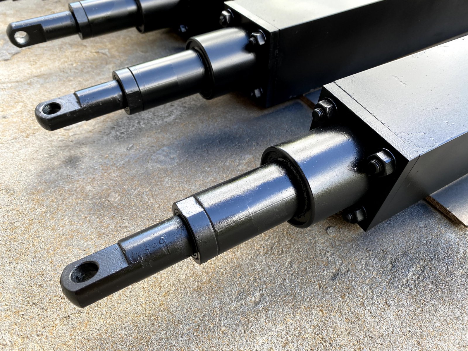

    Wickie did that inside this pipe (shaft) that moves - and this is something that i will not be able to do and that actually makes 50% of the noise. in my case it is mainly due to the fact that my pipe is like 3mm thick only...
    but my plan for that is to buy bike/cross rubber lag covers and that will silence it to some extent as well as provide some dust covering. no to mention aesthetics ;)

    Hi @pooh,
    What is the thickness of your push rod to make the thread and what is the thread type? I wonder if I will weld a the mount directly on the push rod tube.
