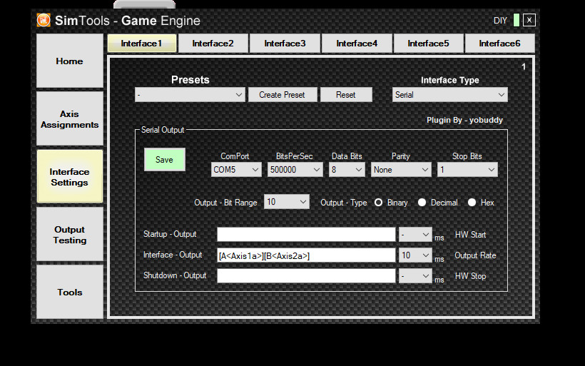

    Which link is for me? I don't fully understand i must modify existing code? I want to add 3 servo to 2dof that work same time. I found serwo code but this is not for me. Sorry my language barrier is i think to high. Every link I read is about serwo but not 2dof and gseat so I don't know how to add another motors

    https://www.xsimulator.net/community/faq/arduino-code-for-servo-g-seats.318/
    Code and sim tools settings from this link

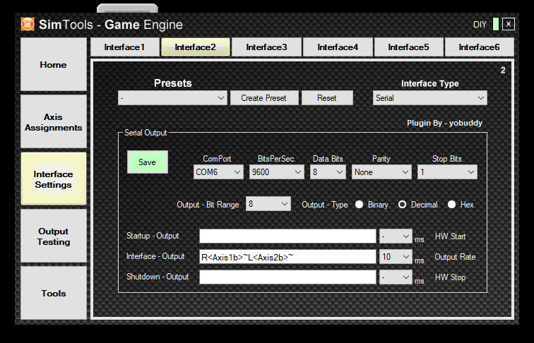

    I need to add 3 serwo ; 2 for sway (left, right) L, F Axis2a, 2b with settings Simtools 2.4 to prevent negative vales and movement https://www.xsimulator.net/communit...p-to-prevent-negative-vales-and-movement.340/
    SIM tools is wonderful software it can hold to 6!!!! Interfaces so I set it up to interface 2 with another port with my old serwo to check it. It's work like a charm so now I want to my serwo and other stuff like from RacingMat's https://www.xsimulator.net/community/threads/wip-racingmats-closed-circuit-gseat.14071/

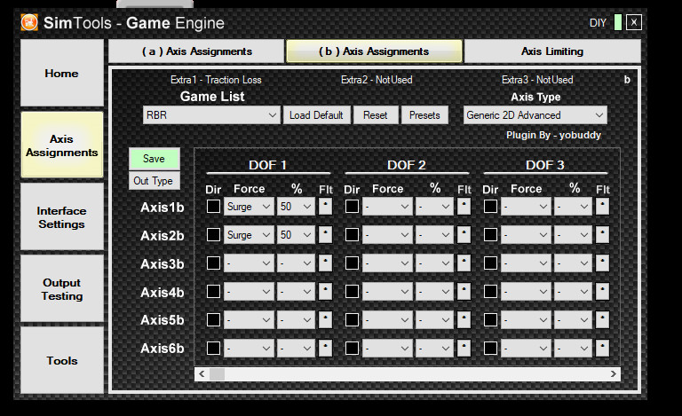

    ok there it is. Maybe i start understand , am i right? i need to add another axis (b ?) to existing profile. there r my testing settings in b axis assignment i put 2 motors that will pomp pressure for surge , is it ok ?

    You could use R<Axis3a>~L<Axis4a>~ for the servos and configure all your axis assignments on the same section.

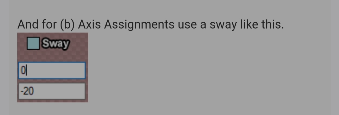

    OK and for sway? For exemple letters F and B
    When I want to prevent negative values? ~F<Axis1b>~B<Axis2b>~? ) And set it in tuning center like on picture? Is this won't affect 2dof tuning settings? Or better use modified arduino code lift only? (when I use modified code No need to set tuning center like on screen?)

    I can't becouse of tuning center existing for 2dof?

    I make gseat axis like 1b, 2b and it's works but serwo works only when push brakes, i need it to works when push throttle? And this is running center goes i think. How to set it?@noorbeast @RacingMat @MarkusB
    21,713
    151,985Coins
    +11,061 / 56 / -2
    I am suggesting you don't use the b axis designation at all, stick to a.
    I suggest you deal with Axis Allocations, not the Tuning Center.
    The DIR box being checked orange or not in Axis Assignments determines which way an axis moves.

    Yes but I checked the DIR box and serwo works only with braking no
    Yes but I think I checked this and this no the direction problem but bo movement at all on the throttle side, only all movement when braking

     Thank You for advice. I made it
    So:
    1. create another axes on (a) section like:
    Axis3a,....
    2. Allocate % and run game.
    3. Run tuning center and change preferred section and up or down and other set 0
    4. Save for axis assignment B!!!!
    5. Set tuning center as previous.
    6. Save for A axis assignment.
    7. Change on sim tools interface settings letter A to B like Axis 3a to Axis3b.
    8. Change on Axis Assignment
    DONE
    U have movement only for (in my case) throttle
    Thank you @noorbeast for tolerate me through my tough learning

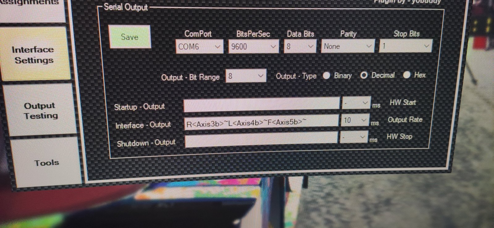

    1,110Coins
    +74 / 0 / -0
    I have some problem. My serwos arrived and I wanted to check it out connect all to 5v and 4,5,6 pins and when I try to check how it work on sim tools they worked well but when I try to quick change directions sim tools crashed. Any ideas?
