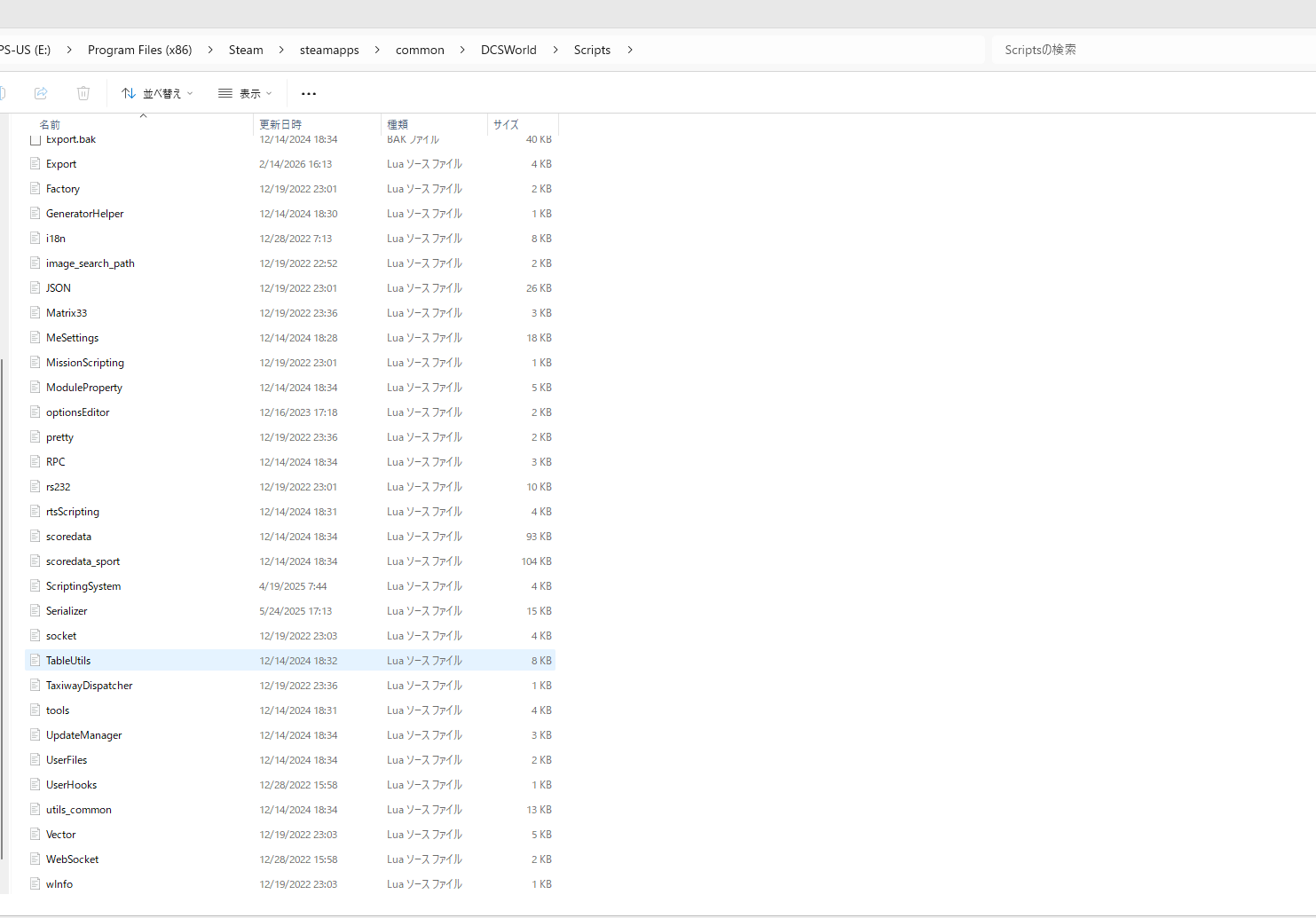

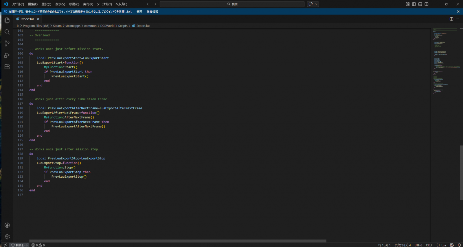

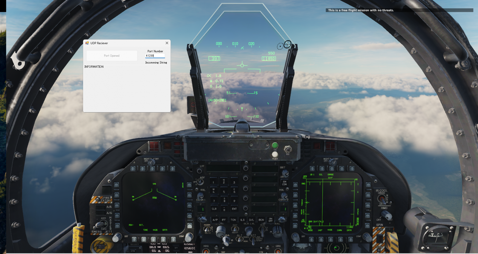

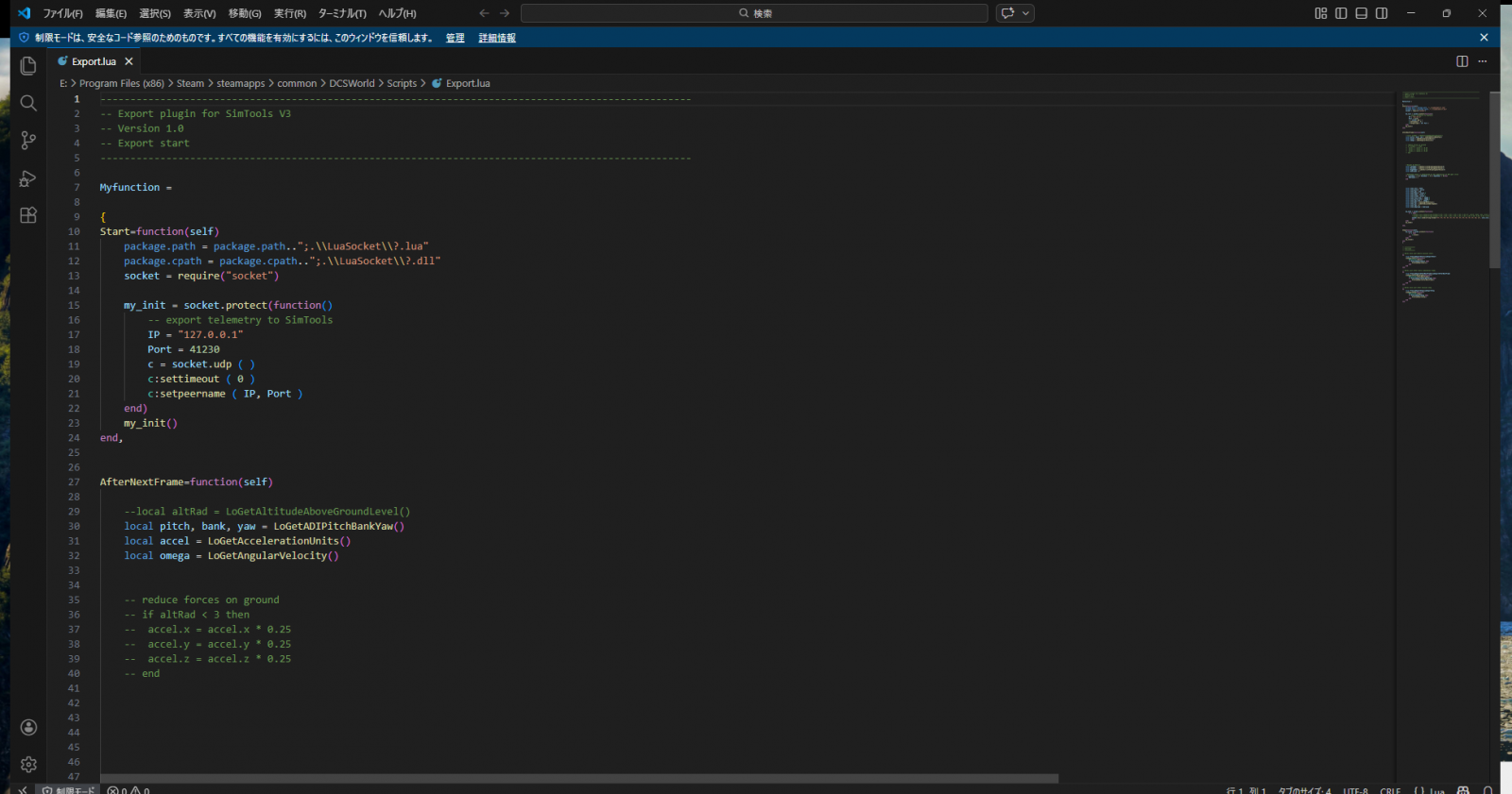

    I cannot get any motion/telemetry from DCS in SimTools v3. I have read through past threads and tried suggested fixes, but the issue persists.
    Current Status:
    • Export.lua: Exists in the correct DCS Scripts folder (Image 1 attached).
    • File Content: Seems correct (Image 2 attached).
    • UDP Test: No data received when checking with a UDP listener (Image 3 attached).
    • Other Sims: MSFS2020 and racing sims work perfectly.
    • SimTools Version: v3 only (never used v2).
    My Question: I suspect a conflict with other Lua files in the same folder.
    • Does anyone know how to isolate/identify a "bad" file causing interference?
    • Any advice on how to resolve such conflicts?
    Thank you in advance for your support.

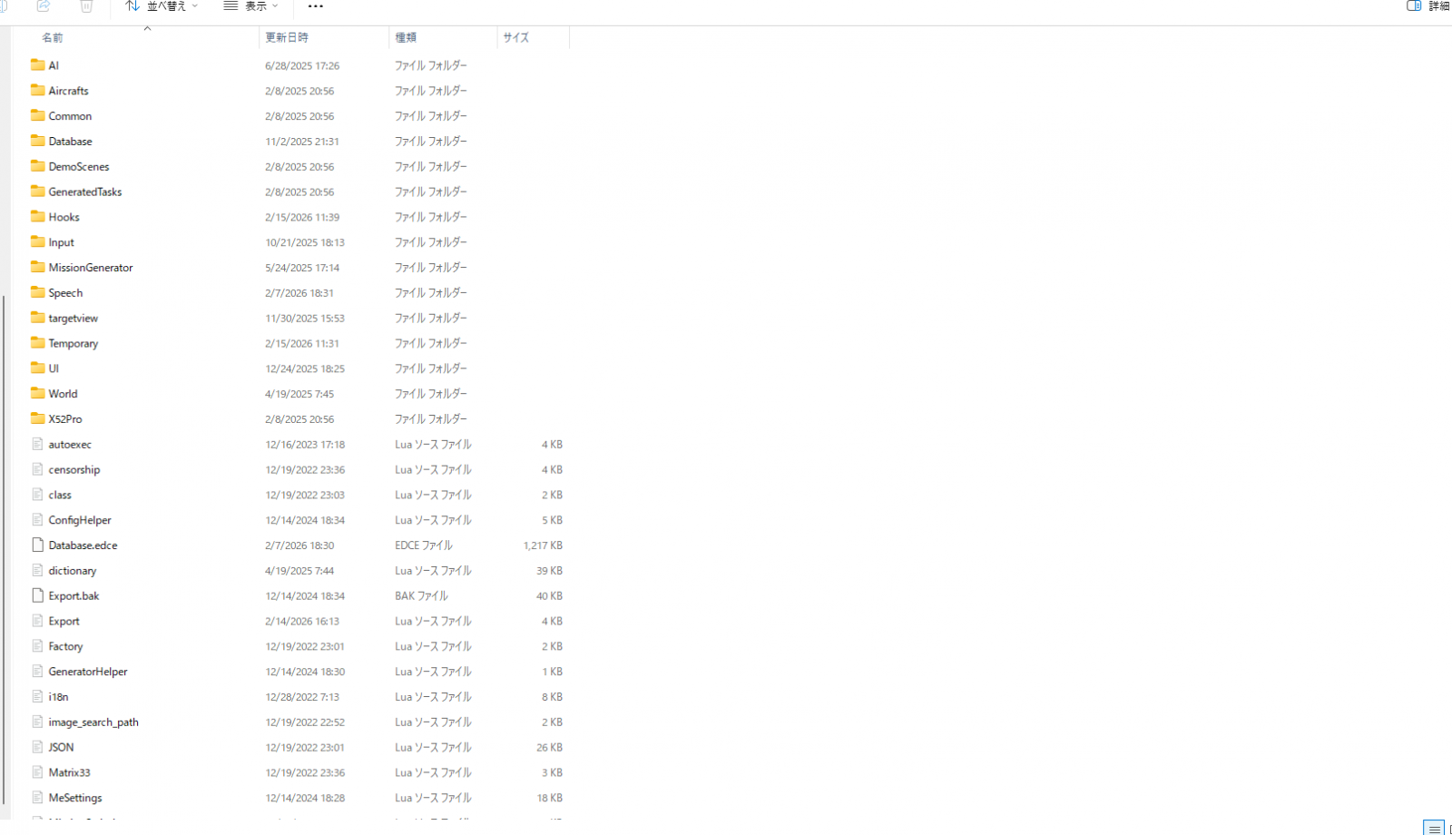

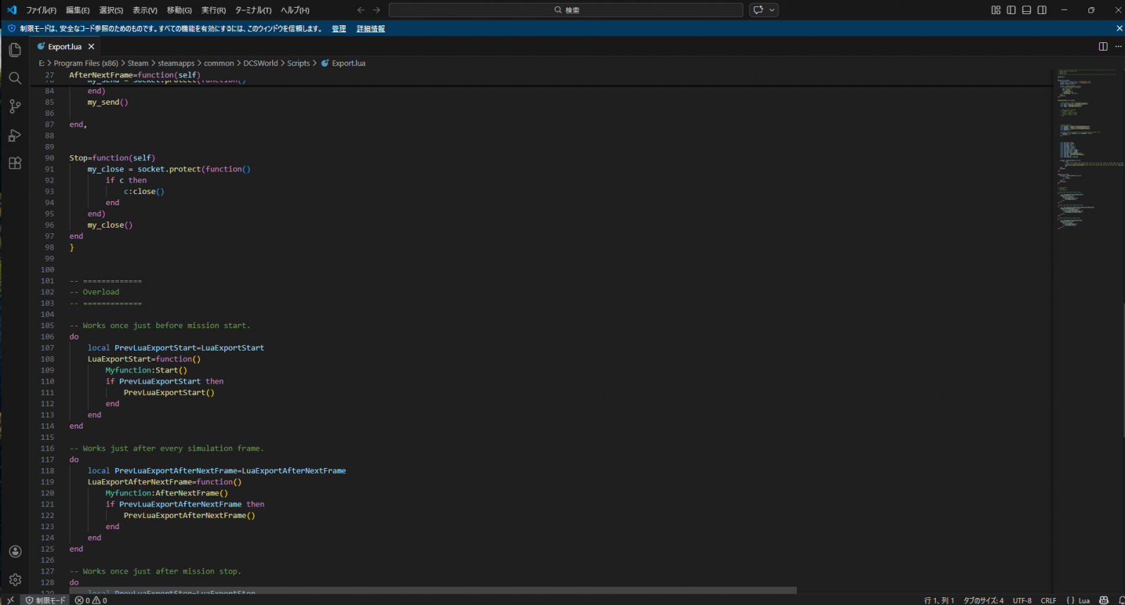

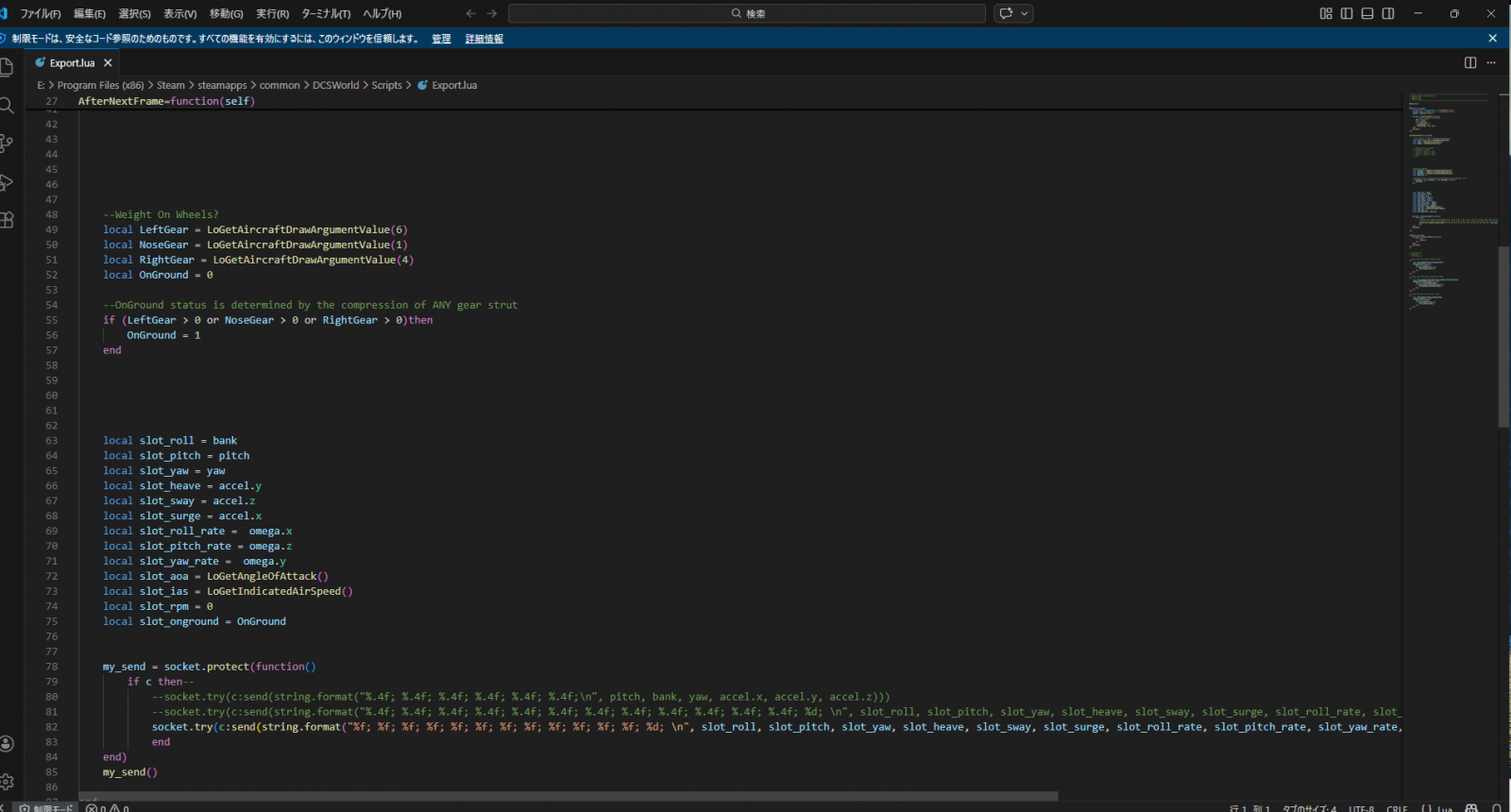

  12. yo-hi
    yo-hi New Member
    Feb 15, 2026
    28Coins
    The issue is now resolved. I found that when installing the DCS plugin, the export.lua file was automatically placed in the Scripts folder within the DCS installation directory.
    However, it didn't work until I moved the export.lua file to the following path:
    C:\Users\[Your (User Name)]\Saved Games\DCS\scripts
    If you don't have a "scripts" folder there, you will need to create one manually. Once I moved the file, everything started working perfectly.
    I’ve been struggling with this for a week, and I finally figured it out today—on my birthday! Thanks for the support.

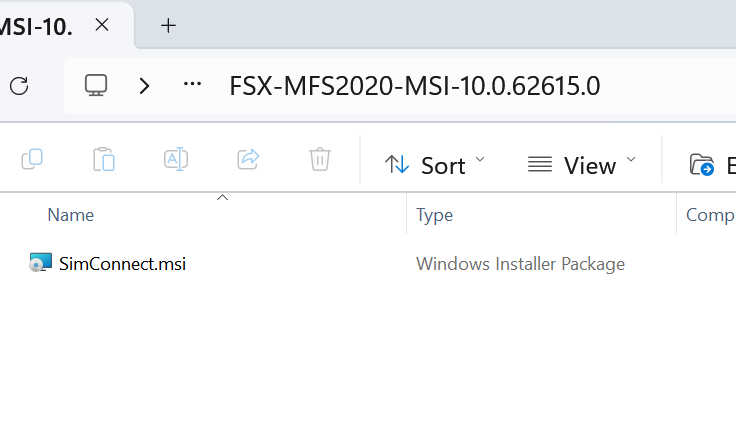

    After updated to windows 11 lost the movement of the rig on Prepar3DV5 , MSFS2020 and FSX
    So far deleted and reinstall the plugin, Repo Njmotions, simconnect MSI10.0.62615.0 still no luck
