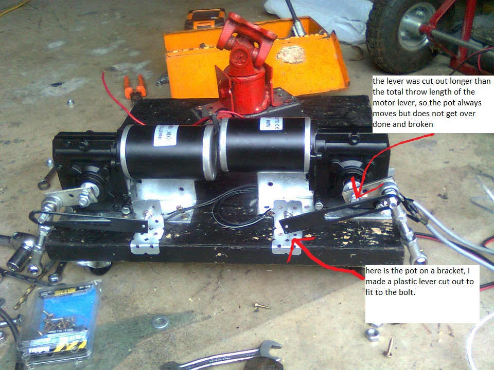

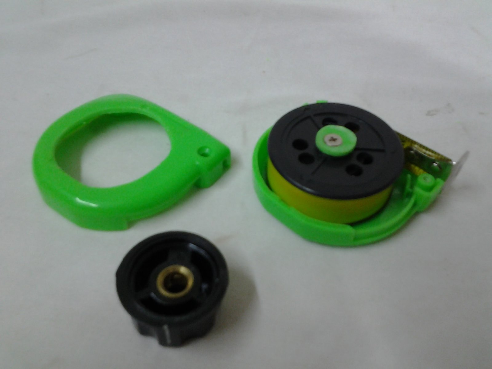

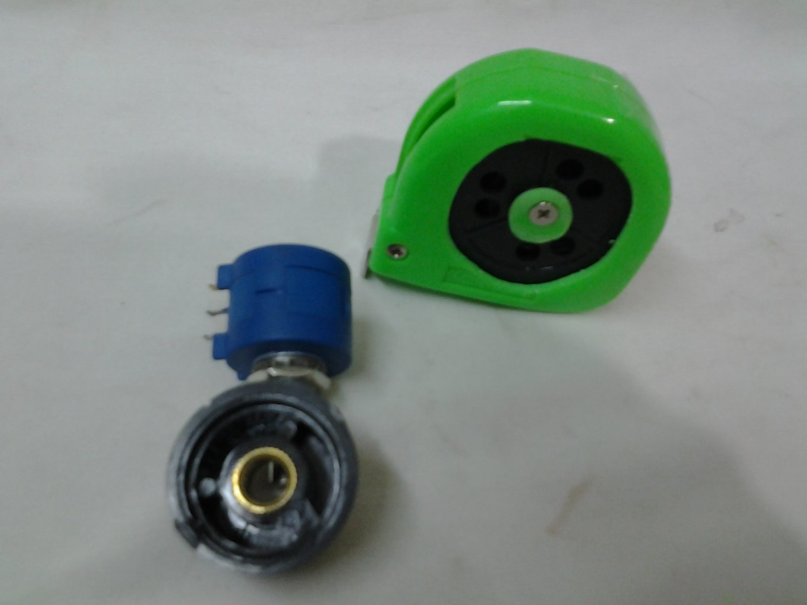

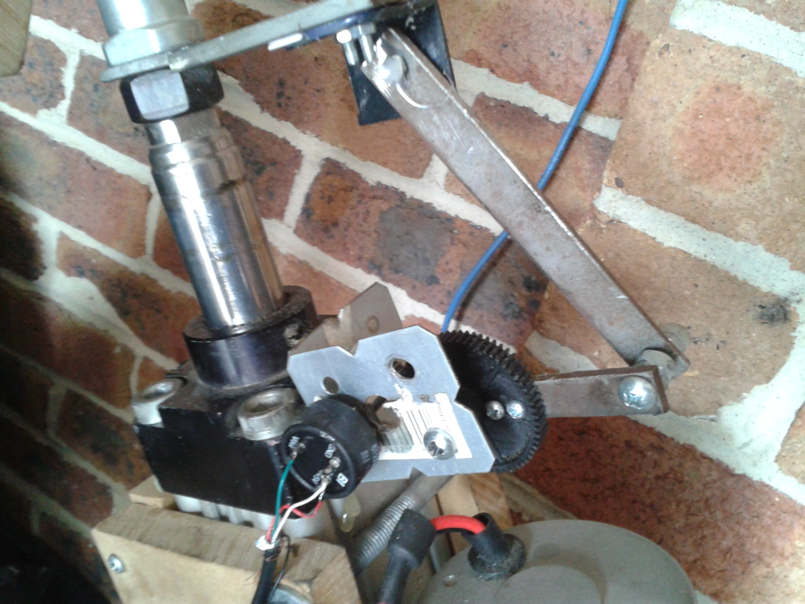

How to choose potentiometer
With Arduino, prefer 10k pots
See the comments here regarding choosing a potentiometer or Hall Sensor: http://www.xsimulator.net/community/threads/how-to-choose-potentiometer.8251/
See here for different ways to mount and protect potentiometers and Hall Sensors: http://www.xsimulator.net/community/faq/how-to-connect-protect-a-potentiometer.13/

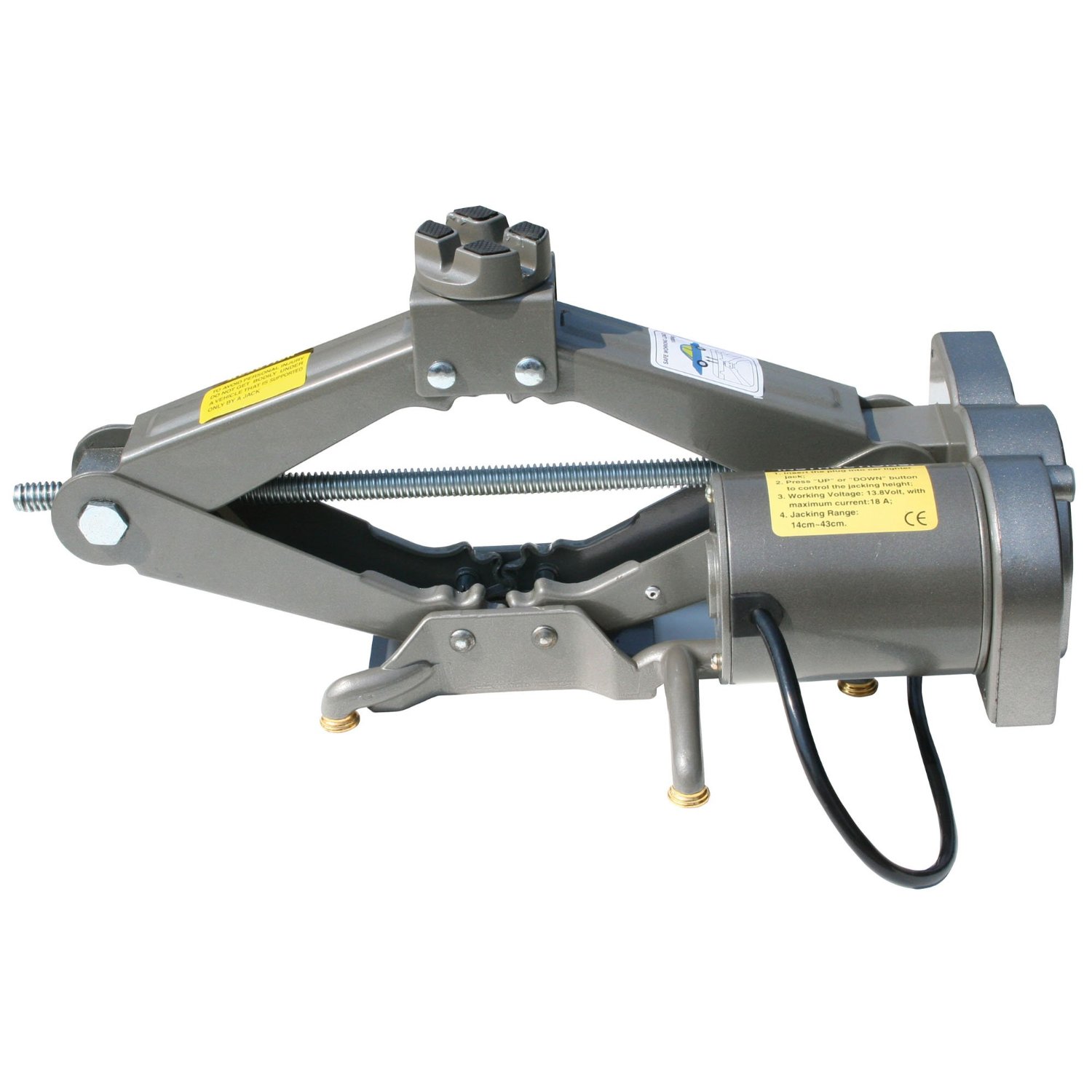

Modify electric jack motors for sim use
One possible alternative to popular worm gear DC motors is to use cheap and more readily available electric jacks, with a simple mod as explained by @mariano68: http://www.xsimulator.net/community/threads/2dof-foot-mount-sim-powered-by-12v-electric-jacks.7601/

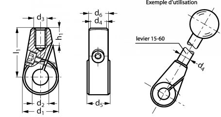

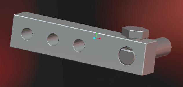

How to attach lever / crank / arm to motor shaft?
yours
Mat

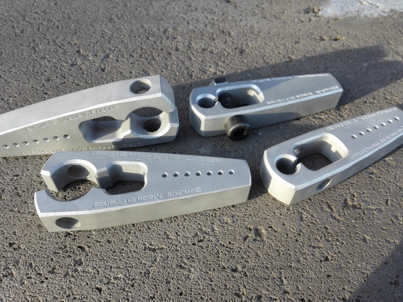

► Thomconcept

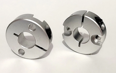

► ring shaft retainer
https://www.aliexpress.com/item/4000571545047.html
3€ many size available
just bolt your arm (the screw head are conviently hidden into the counterbore holes)
► on shelves product:
► DIY
from richardcreation
from egoexpress
► Bike Crank Arm => only for Ø23,7mm shaft
https://www.google.ch/search?q=hollowtech+crank
Mountain Bike Left Crank Arm for SHIMANO amazon 20$
aliexpress Hollow Bicycle Left Crank Arm Mainly for SHIMANO 14€
![[IMG]](proxy.php?image=https%3A%2F%2Fwww.xsimulator.net%2Fcommunity%2Fdata%2Fattachments%2F80%2F80427-7ad755b6ba0a7ee8a79357f9a3087991.jpg&hash=f87b8b831f47a552bcf01c04d6476b4e)

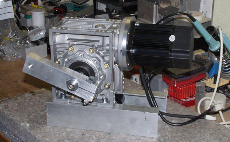

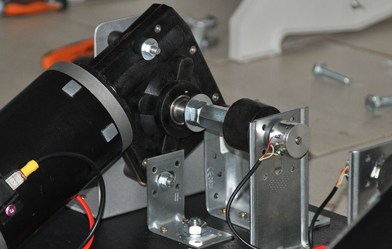

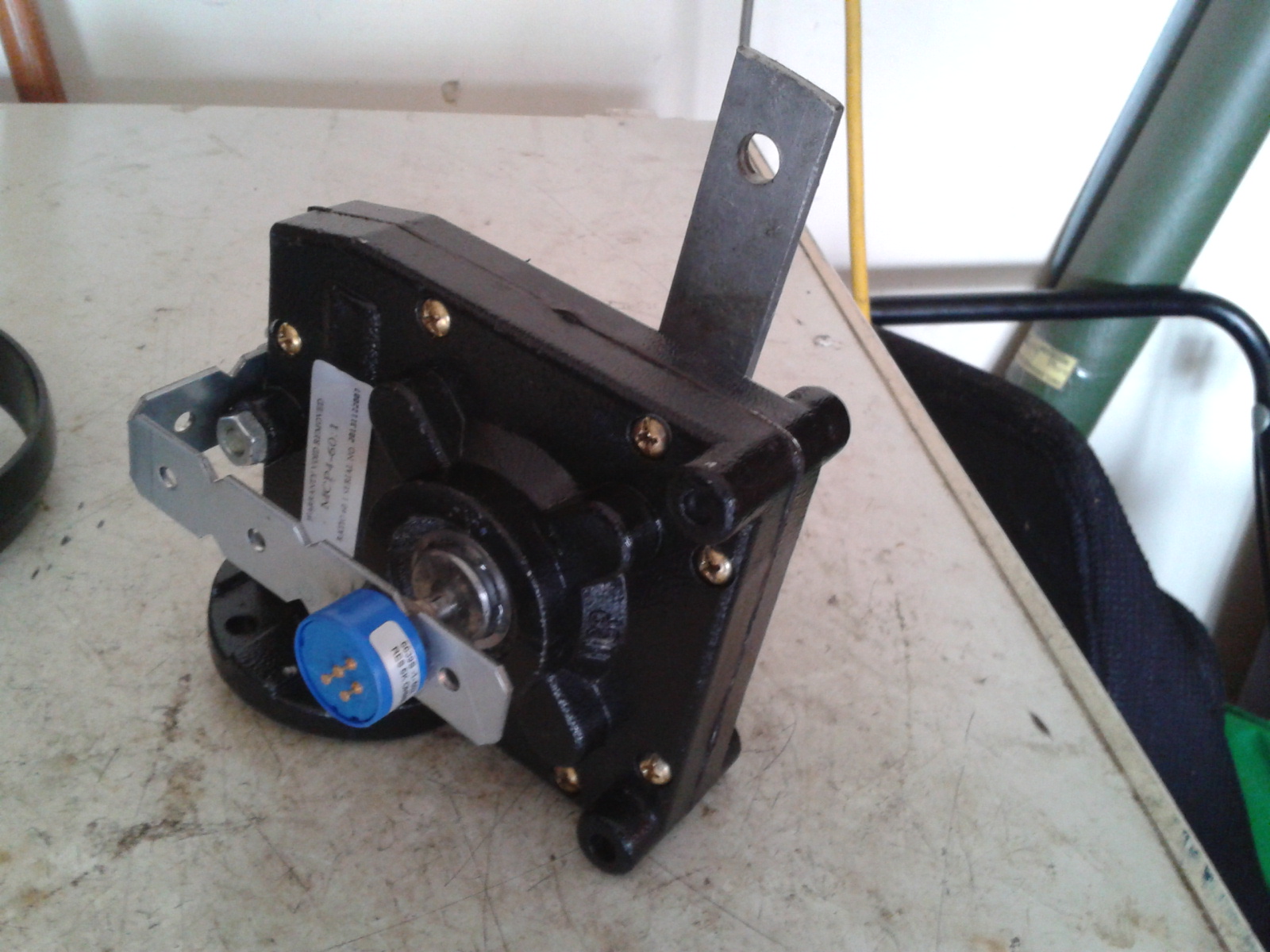

► Wormdrive gearboxes can be hollow shaft or solid shaft, so the approach to attaching levers is different.
For solid shaft gearboxes that are keywayed @noorbeast suggests the easiest way to attach a lever is to grab the correct sized and length Mild Steel, Black Oxide Plating Rigid Couplings, which have the keyway and grub screws, and just weld the lever on the end: http://www.xsimulator.net/community/threads/using-chinese-actuators.7304/page-3#post-86033
![[IMG]](proxy.php?image=http%3A%2F%2Fwww.xsimulator.net%2Fcommunity%2Fproxy.php%3Fimage%3Dhttp%253A%252F%252Fecx.images-amazon.com%252Fimages%252FI%252F216eLpqhf2L.jpg%26hash%3D81fc0e4539603322dc34a4526bce9980&hash=d595658a5692c769fc7c7dd9a37c1bef)
Another option for solid shaft motors are these bolt on flanges: https://www.robotshop.com/nl/en/14mm-set-screw-key-steel-hub.html

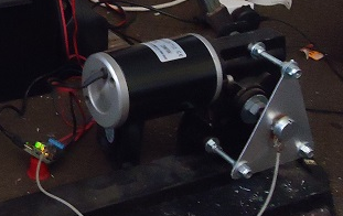

As @Nick Moxley explains with hollow shaft motors you can use the correct sized threaded rod through the hollow shaft and weld nuts to it to secure the levers: http://www.xsimulator.net/community/threads/using-chinese-actuators.7304/page-2#post-85902
![[IMG]](proxy.php?image=http%3A%2F%2Fwww.xsimulator.net%2Fcommunity%2Fproxy.php%3Fimage%3Dhttp%253A%252F%252Fi150.photobucket.com%252Falbums%252Fs102%252Fdavidmoxley123%252FSim%252520Racing%252Fpreview_image_0_95824982x_zps95a8003b.jpg%26hash%3De4346fcdf75c07dcdb7aee822626a6f5&hash=df7c52693e5dde2cb283836d5ff1da07)

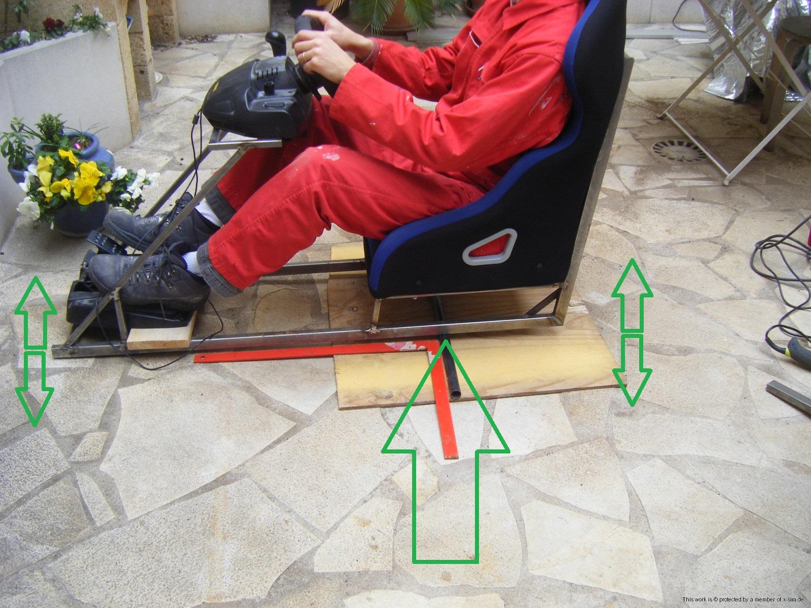

Traction Loss
For games plugins that support Traction Loss it is normally set in SimTools as Extra1, see here for eaorobbie's summary: http://www.xsimulator.net/community/threads/axis-settings-for-traction-loss.5847/#post-61523
If you are looking for some inspiration then here are some example build threads that incorporate Traction Loss:
Pitt linear traction loss: https://www.xsimulator.net/communit...wip-surge_sway-table.5276/page-28#post-163879
Boomslangnz: http://www.xsimulator.net/community/threads/traction-loss-slow-break-out-fast-return.5999/
Pit: http://www.xsimulator.net/community/threads/2550w-3dof-seat-mover-traction-loss-finished.5276/
Nick Moxley: http://www.xsimulator.net/community/threads/2dof-to-3dof-diy-seat-mover.5271/
SeatTime: http://www.xsimulator.net/community/threads/seattimes-dc-motor-sim.5024/
See here for ideas for different types of pivots for a traction loss frame: http://www.xsimulator.net/community/threads/different-ways-to-pivot-traction-loss-frame.6641/
@SeatTime uses 150mm each way from centre - so 300mm total, @Nick Moxley uses 100mm each way from centre - so 200mm total and @SilentChill uses a 200mm lever: http://www.xsimulator.net/community/threads/how-much-movement-in-drift-axis.6837/
Tweaking traction loss - slow break out, fast return: http://www.xsimulator.net/community/threads/traction-loss-slow-break-out-fast-return.5999/

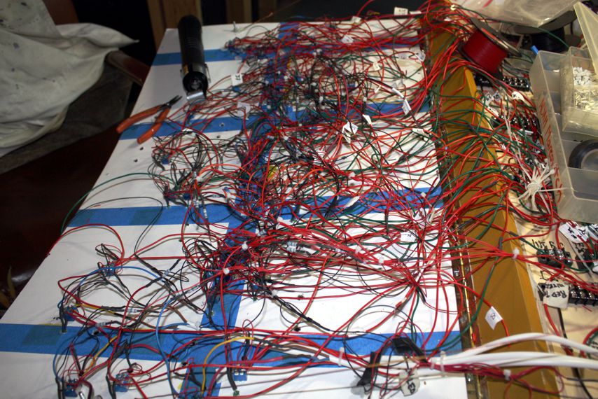

Cable Management
Here is a handy thread on different member ideas to make cable management as easy as possible: http://www.xsimulator.net/community/threads/chaos-wiring.6310/#post-82068

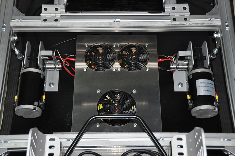

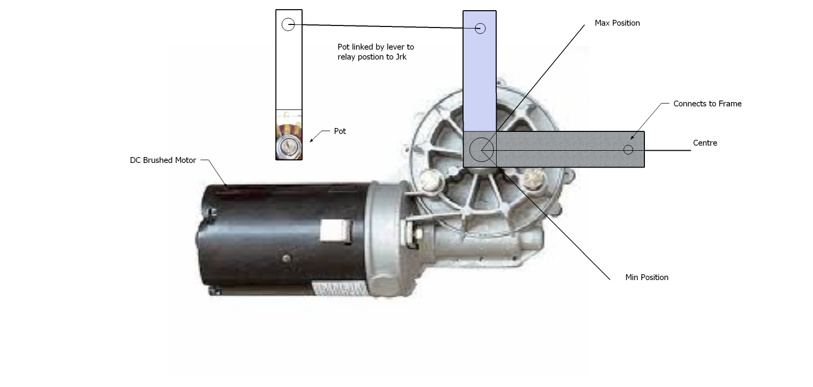

DC winch motors for motion simulators
One possible alternative to popular worm gear DC motors are DC winch motors. Winch motors are generally universally available and affordable. Check out @Pit's advice regarding the Pros and Cons of using winch motors: http://www.xsimulator.net/community...raction-loss-finished.5276/page-12#post-79142
@Pit has also provided information and this video to show the noise level and responsiveness of winch motors, go to 1:10 in the video where the sound of the simulator is compared to spoken words: http://www.xsimulator.net/community/threads/how-loud-are-winches-video-inside.6934/
Winches can be noisy, here @xytras provides an example of a 2000lb 153:1 winch unloaded, which turns at 32RPM: http://www.xsimulator.net/community...ch-motors-and-steering-boxes.6937/#post-79556

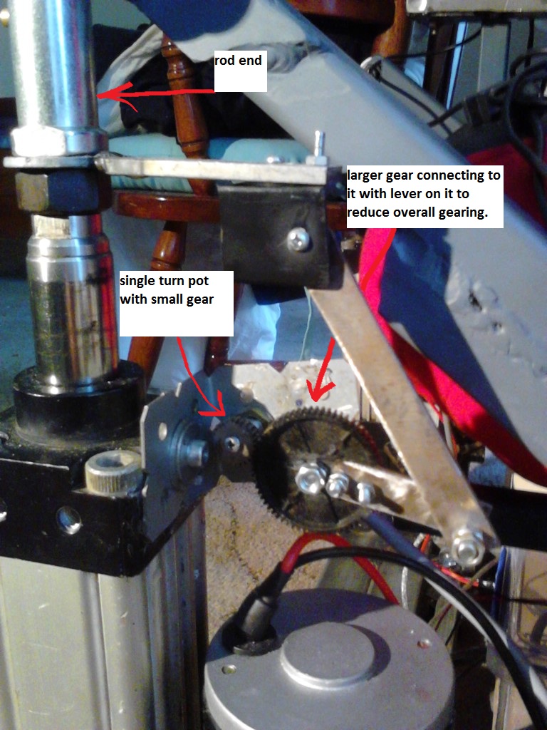

@Ben V took a different route and tested using just the winch motor in conjunction with 25:1 steering boxes with 93 degrees total travel, with the measurered stall torque being 3.5 Nm and the free winch motor speed of 4420 rpm: http://www.xsimulator.net/community...ch-motors-and-steering-boxes.6937/#post-79343
![[IMG]](proxy.php?image=http%3A%2F%2Fwww.xsimulator.net%2Fcommunity%2Fdata%2Fattachments%2F24%2F24466-168644273d22de1086a7963b00270a40.jpg&hash=603afaa4ae5b0bc2ab49ab637af45a0c)

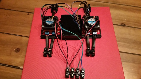

Supports for single or dual IBT-2 motor drivers by @KamiFern: https://www.xsimulator.net/community/threads/ibt-2-support-bracket.19332/
Enclosure for Arduino uno R3 + 3 IBT 2 BTS by @poumpouny: https://www.xsimulator.net/communit...bt-2-bts-7960-motor-driver.18380/#post-245108

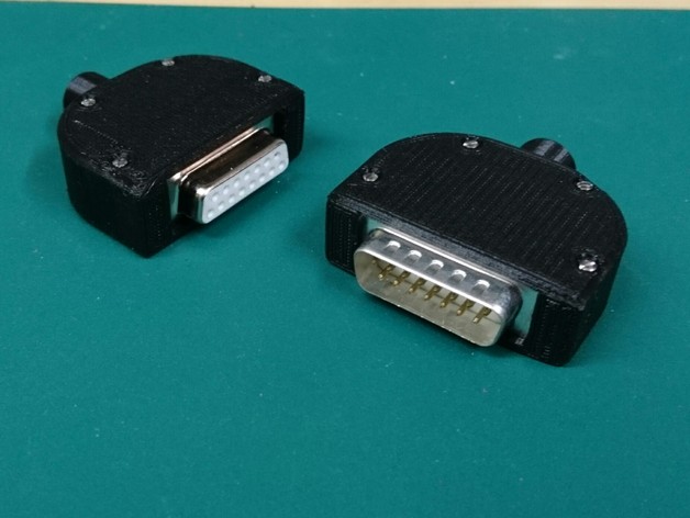

Dsub 15 for OSW builds, submitted by @Nick Moxley: https://www.xsimulator.net/community/threads/dsub-15-for-osw-builds.9385/

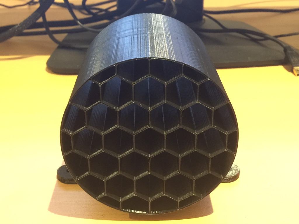

Honeycomb fan air straighteners by @Avenga76: https://www.xsimulator.net/community/members/avenga76.10691/
Modified snap on honeycomb fan air straighteners by @HoiHman: https://www.xsimulator.net/communit...ermoto-and-arduinouno.6876/page-9#post-114138

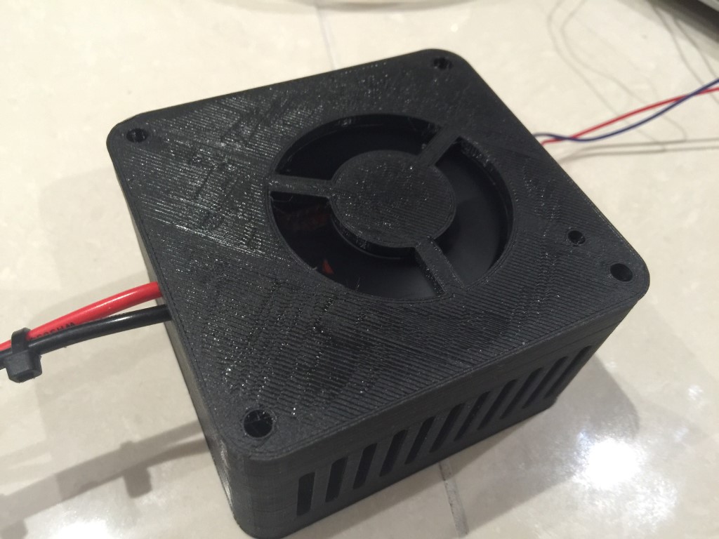

Moto Monster ventilated box by @Avenga76: https://www.xsimulator.net/communit...ermoto-and-arduinouno.6876/page-7#post-113677
Moto Monster ventilated box with internal fan by @Avenga76: https://www.xsimulator.net/communit...ermoto-and-arduinouno.6876/page-9#post-114400

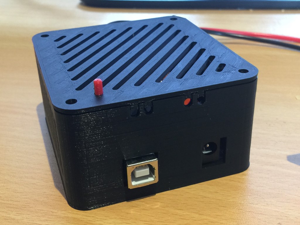

Combined 3D printed Arduino case with dual Motor Monster wings by @stevemontuno : http://www.thingiverse.com/thing:1510217/#files

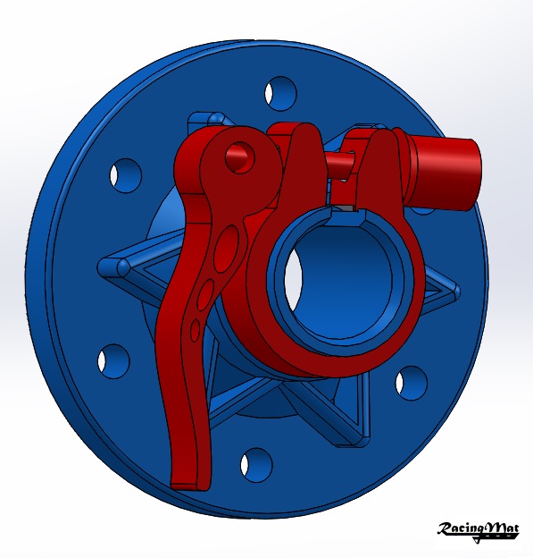

3D quick release steering wheel hub by @RacingMat: http://www.xsimulator.net/community/threads/3d-printed-quick-release.6360/#post-70710

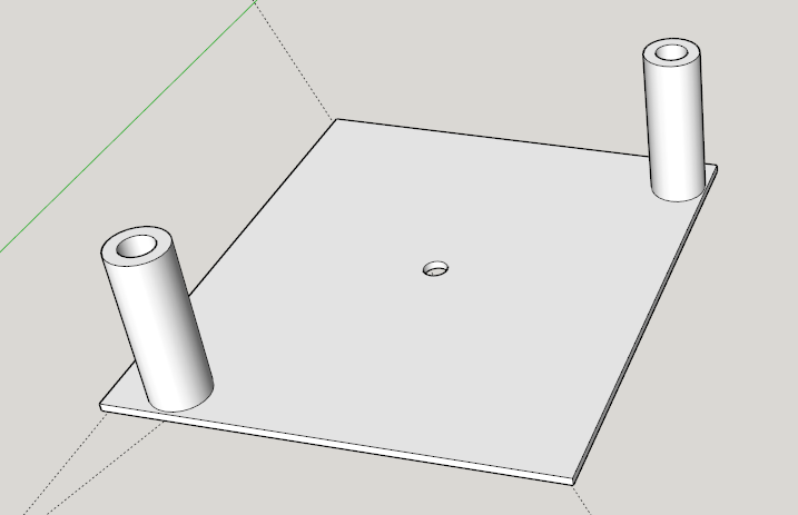

Below is a summary of a diverse range of 3D Printed objects made available by @Ville Pesonen in one package: http://www.xsimulator.net/community/threads/2dof-motion-simulator-build.6196/page-7#post-88219

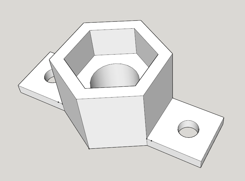

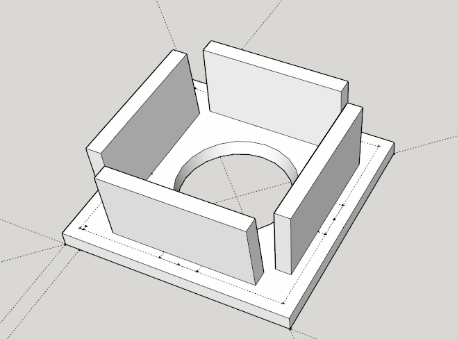

CapHolder
It's basically a mount for a nut that you can screw to somewhere.
![[IMG]](proxy.php?image=http%3A%2F%2Fwww.xsimulator.net%2Fcommunity%2Fdata%2Fattachments%2F27%2F27232-79e0c9bb4581b3085790be2857e3ca0a.jpg&hash=9bc10e7f1c4f3b7681e4c9906c959eca)

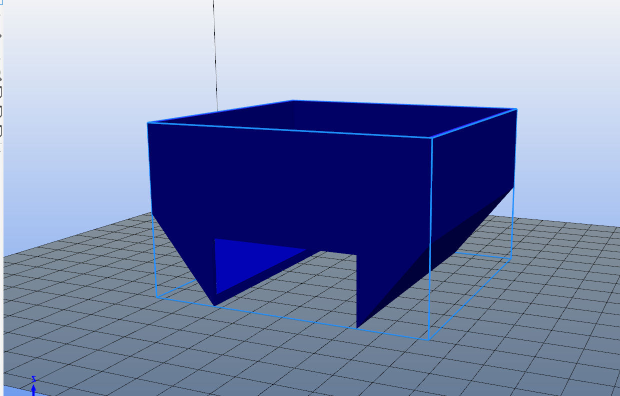

Case:
Never managed to print this...

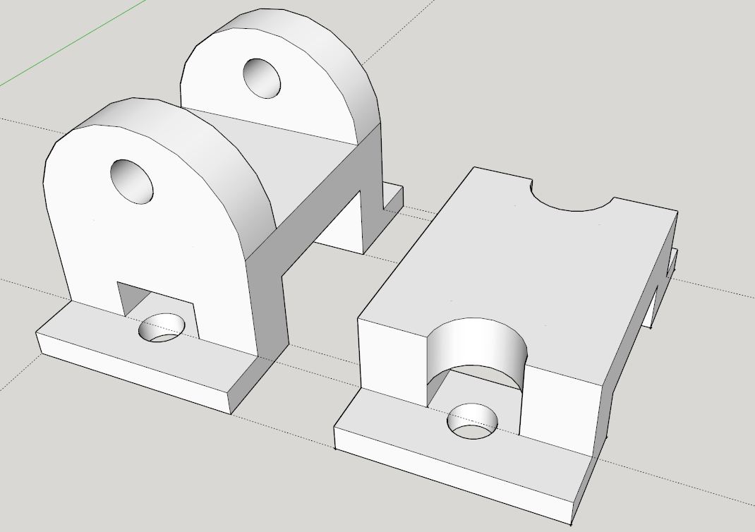

Gas spring mount:
Part to hold gas spring in place. It clamps around 30x30mm tube

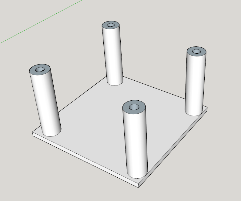

HBridge Holder:
You can screw a cheap chinese H bridge to this

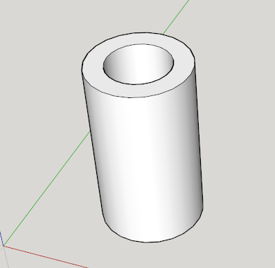

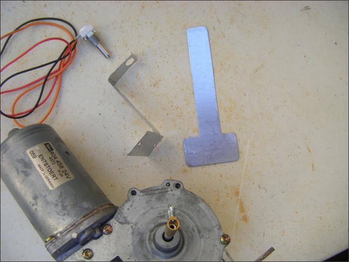

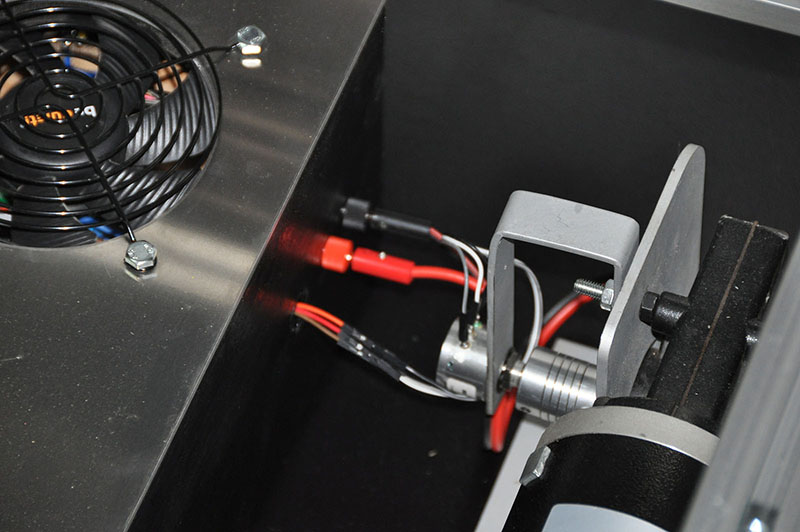

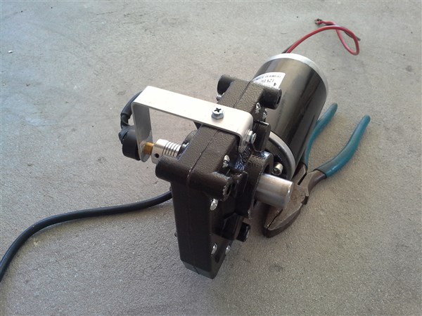

Potentiometer connector
just a tube that goes over the potentiometers shaft and can be glued to the shaft of a motor
![[IMG]](proxy.php?image=http%3A%2F%2Fwww.xsimulator.net%2Fcommunity%2Fdata%2Fattachments%2F27%2F27239-dd9f4d1e2eab26ce841bf09a347e9d83.jpg&hash=939d7e027a784f6936cb8eab0c17cb58)

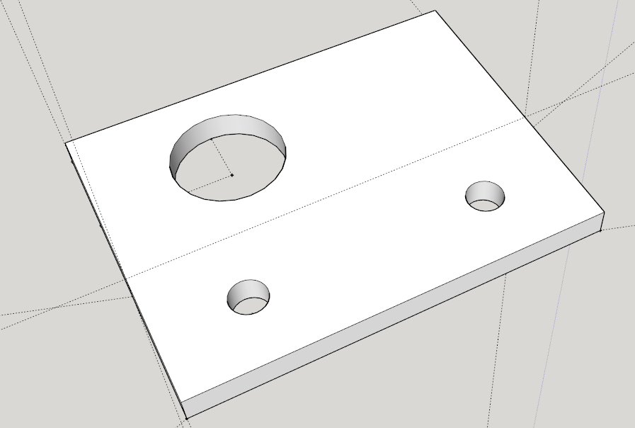

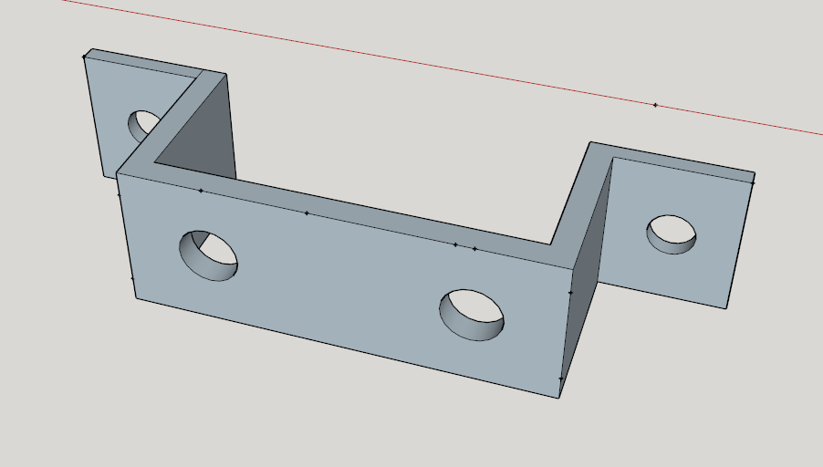

Potentiometer holder:
I used this to mount potentiometers next to the motor. the holes are in line with the motor mount holes. I can't remember the model of the motor that I have...you can find it somewhere in this build thread.
![[IMG]](proxy.php?image=http%3A%2F%2Fwww.xsimulator.net%2Fcommunity%2Fdata%2Fattachments%2F27%2F27240-f99a08501ebdb18139504cec0cc7f285.jpg&hash=442eeb6b5e2af5f4ebec8fe326fbb146)

DIY Actuators
Modified CFF actuators by @bsft: http://www.xsimulator.net/community/threads/diy-actuators-plans-by-ian-bff-shortened-by-me.5279/
Belt drive linear actuators posted by @RacingMat: http://www.xsimulator.net/community...kickstarts-a-linear-actuator.5274/#post-51851
OpenBuild linear actuator posted by @telfel, note subsequent thread discussion on better motors being needed: http://www.xsimulator.net/community...th-a-bunch-of-stroke-options.6750/#post-75326
Guide to setting Feedback on 50:1 and 60:1 gearbox motors
These are the steps @Archie uses: https://www.xsimulator.net/community/threads/setting-feedback-on-50-1-60-1-boxes.9116/
Here is @bsft's approach: http://www.xsimulator.net/community...er-gs-4-simvibe-gauges.5596/page-7#post-68521

Find the Center Of Gravity to balance a motion simulator
before determining the COG for your motion simulator.
No need of maths to find the center of gravity: just a round pipe and a friend to help to balance your motion simulator
Make sure the pipe is orthogonal to the side
http://www.xsimulator.net/community/threads/from-atoz-2dof-arduino-wiper-playseat.4616/#post-45417
