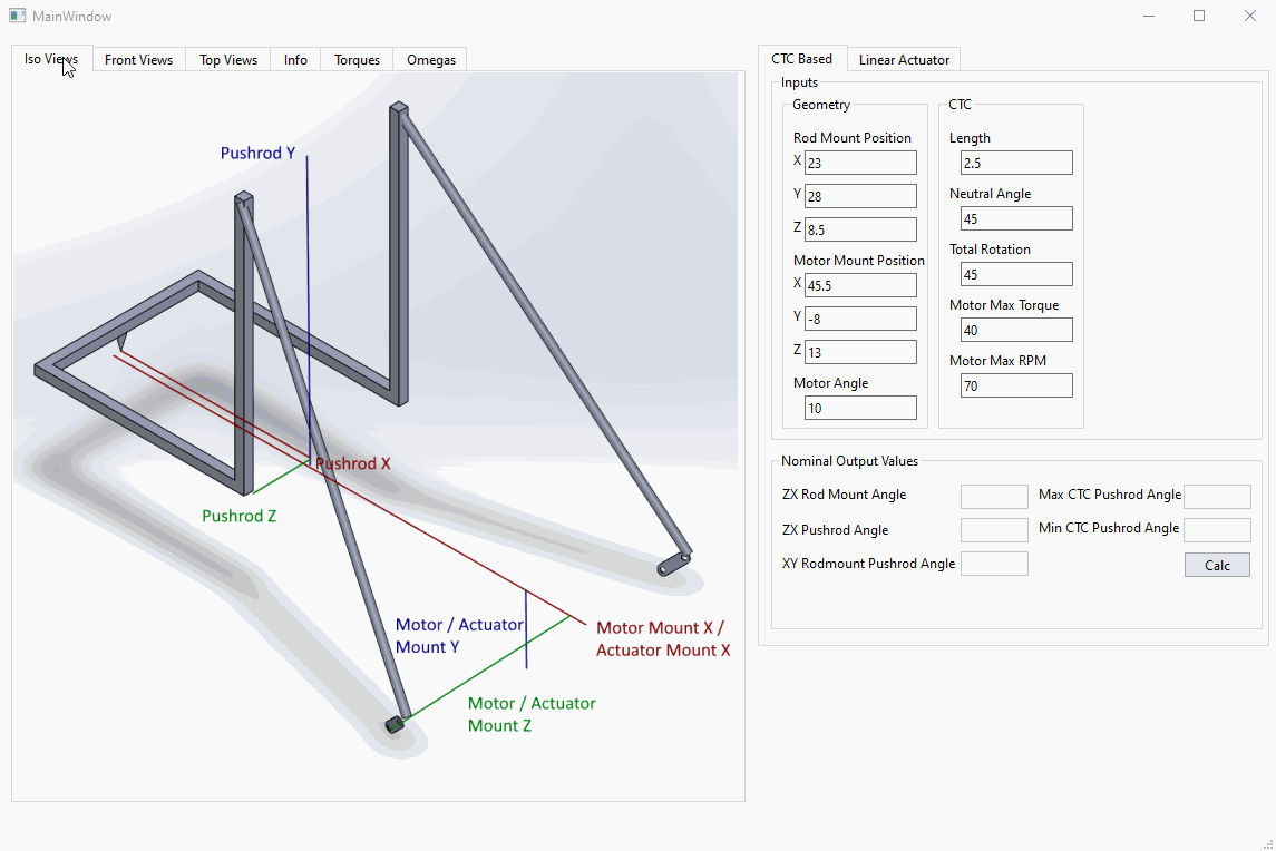

Motion Visualizer
![[IMG]](proxy.php?image=https%3A%2F%2Fraw.githubusercontent.com%2Fchadat23%2FMotionVisualizer%2Fmain%2Fanimation.gif&hash=d3a2cd30bbf7b487856b0fe5e2283109)

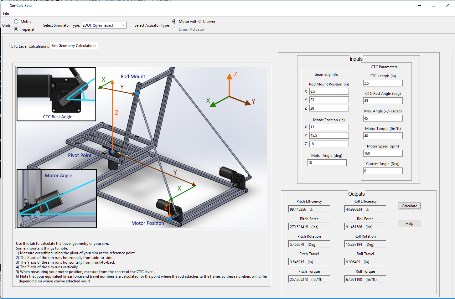

SimCalc - Calculate linear speed and forces of your design
You can download SimCalc directly from Xsimulator.net: https://www.xsimulator.net/community/marketplace/simcalc.184/
You can check out the mathematical assumptions behind SimCalc here: https://www.xsimulator.net/community/threads/simcalc-by-tim-mcguire.11277/page-2#post-140469

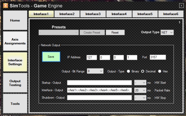

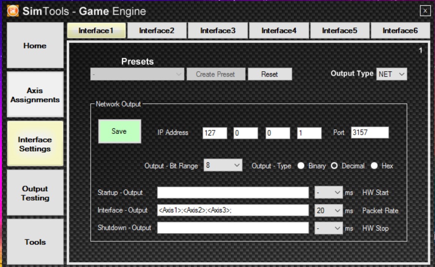

Here are the interface and axis settings:

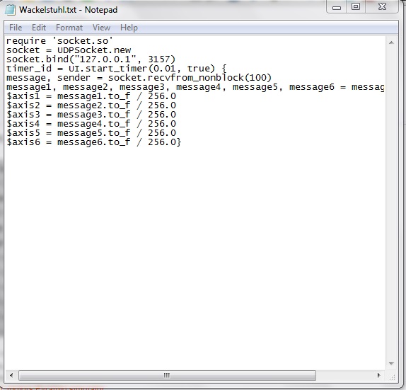

As @speedy points out the files in the 'Wackelstuhl.rb' file which is located in the C:\Users\Your_User_Name\AppData\Roaming\SketchUp\SketchUp 2015\SketchUp\Plugins folder has the 3rd axis inverted: http://www.xsimulator.net/community/threads/sketchup-sketchyphysics-simulation-faq.7864/#post-95596
The 'Wackelstuhl.rb' file can also be edited to provide a full 6DOF like this:
require 'socket.so'
socket = UDPSocket.new
socket.bind("127.0.0.1", 3157)
timer_id = UI.start_timer(0.01, true) {
message, sender = socket.recvfrom_nonblock(100)
message1, message2, message3, message4, message5, message6 = message.split(";")
$axis1 = message1.to_f / 256.0
$axis2 = message2.to_f / 256.0
$axis3 = message3.to_f / 256.0
$axis4 = message4.to_f / 256.0
$axis5 = message5.to_f / 256.0
$axis6 = message6.to_f / 256.0}

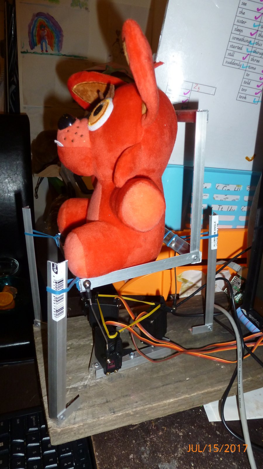

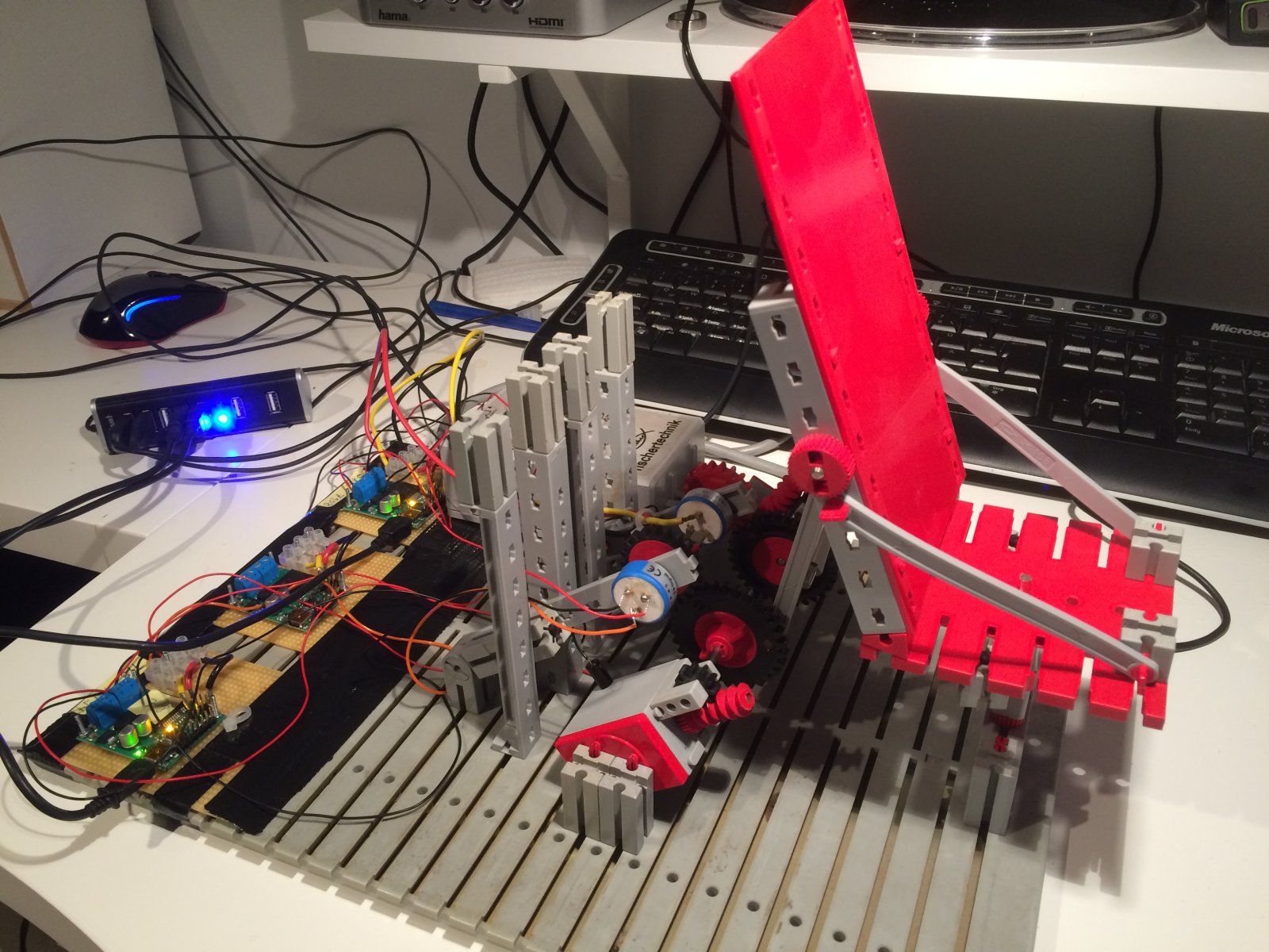

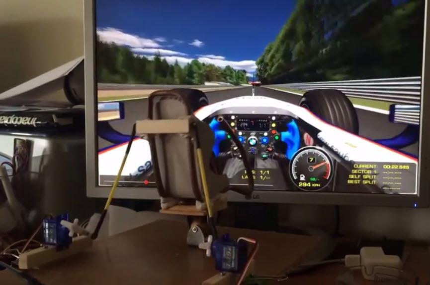

Build a working model to test your design ideas
You can grab @Iain Dodds modification of @eaorobbie's code so you can use the Adafruit 16-Channel PWM / Servo HAT: https://www.xsimulator.net/communit...tor-proof-of-concept-model.15376/#post-207505
You can start small. If you are really adventurous and are looking for the ultimate test model then check out @hooshang's impressive 6DOF model: http://www.xsimulator.net/community/threads/6dof-platform-with-small-dc-motors.5634/
Thanks to @Leo Salo you can use a RaberryPi to drive your RC model simulator: https://www.xsimulator.net/community/threads/3dof-concept-model-using-raspberrypi.10570/#post-136827

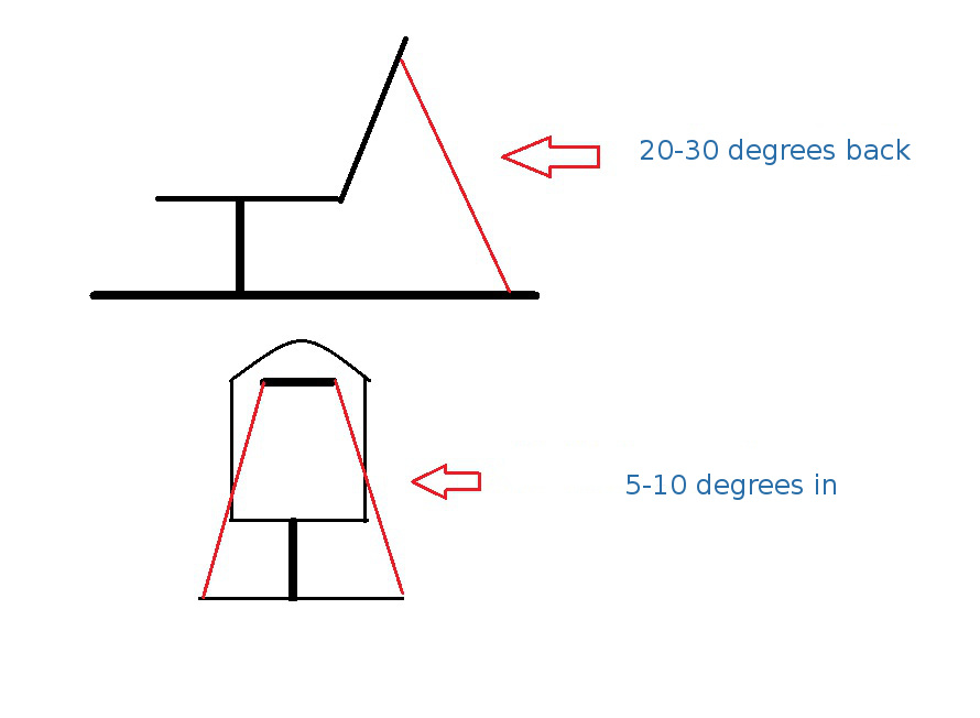

Shoulder mount rod angles
Further information on the mathematics affecting angles and linear speed can be found here: http://www.xsimulator.net/community/faq/calculating-basic-linear-speed-and-forces.89/
