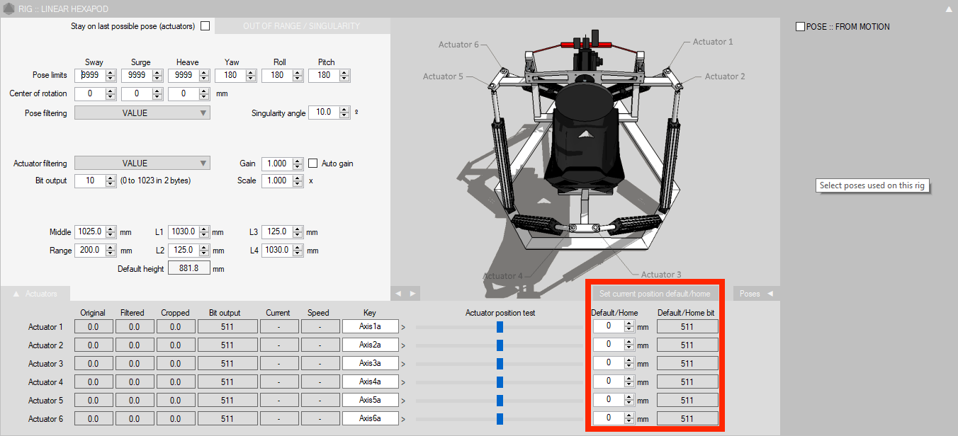

2DOF RC servos harness tensioner with PT Mover
![[IMG]](proxy.php?image=https%3A%2F%2Fwww.xsimulator.net%2Fcommunity%2Fdata%2Fattachments%2F81%2F81921-fbac14eed0d098f93dc5a1ed1ae54292.jpg&hash=9bfa74c6281e1004d88cae4eee74c588)
Set the Park/Rest/Default position
Zero is the middle of the actuator, put there the minimum for the actuators ( in all actuators).
In the above image I would use -200 in all actuators to have them in the lowest position (it's the range of the actuator).
