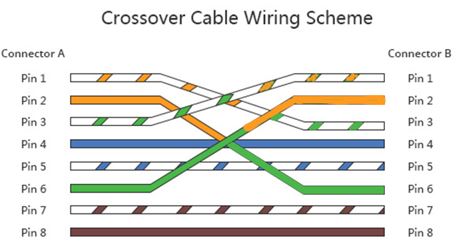

I converted a standard Ethernet cable (one should have a spare cable lying around in the drawer!) into a Crossover cable by this method.
Carefully slit open the sheath in the middle of the cable and pull apart the following four wires.
  1. Orange and Orange/white;
  2. Green and Green/white;
  3. Cut and strip these four wires;
  4. Now solder the Orange/white wire from Connector 1 to the Green/white wire from Connector 2 and cover it with heat shrink tube;
  5. Ditto for the Orange wire from Connector 1 to the Green wire from Connector 2;
  6. Ditto for the Green/white wire from Connector 1 to the Orange/white from Connector 2;
  7. Ditto for the Green wire from Connector 1 to the Orange wire from Connector 2;
  8. Leave other cables alone;
  9. Cover these connections with a tape or heat shrink tube.

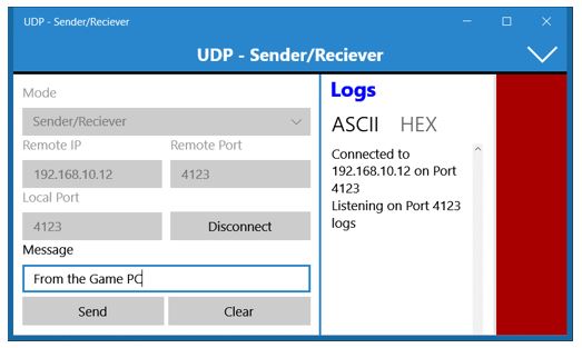

In order to test the cable, I used the UDP Sender/Receiver App from Microsoft/Google store.
Download this app to the PC and the Xbox One X.
Launch the UDP Sender/Receiver App in both devices.

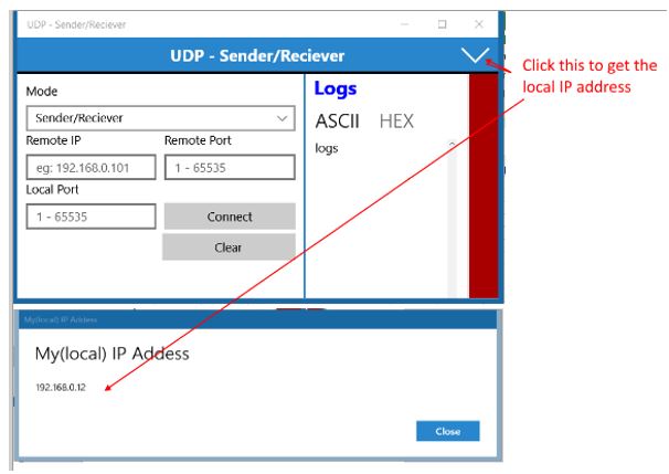

Note the local addresses (say on the PC 192.168.0.101, and on the Xbox One X 192.168.12.10)
Enter the PC address 192.168.0.101 as the Remote IP on the Xbox One X and vice versa.
On both devices enter 4123 as the Remote and Local Port
Now click the Connect button. You should see the following dialogue box.

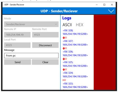

Enter a test message, say "From the Game PC" on the PC and "From the Xbox One X "on the Xbox One X.
Click send and you should see the messages appear in green (Local)/red (Remote) under the Logs.
This proves that your CrossOver cable is ok.

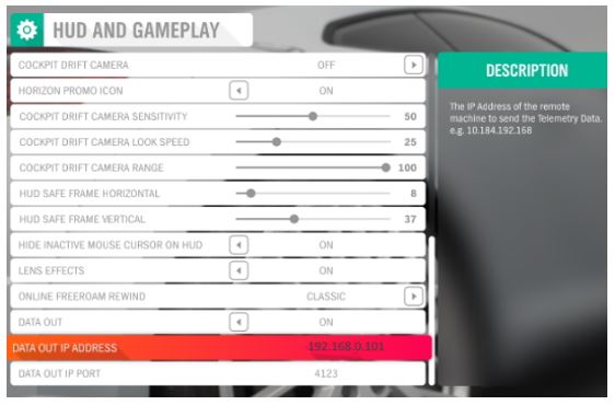

In FH4, under HUD and Gameplay, Turn DATA OUT "ON", DATA OUT IP ADDRESS " (192.168.0.101), DATA OUT IP PORT "4123" and Accept.
When you run FH4, you should see the motion data from FH4 on the UDP Logs.

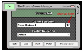

Now launch the SimTools PluginUpdater, Drag and Drop ForzaHorizon4_GamePlugin.V2.0.0.2.zip
Launch SimTools, change the IP addresses on both the Game Manager and Game Engine to 192.168.0.101. This is your PC address as per the UDP Sender/Receiver.
Once you have ensured that FH4 is patched and the Axis etc are correctly set up, when you run FH4 on Xbox, you should see the motions.
If not click the manual start button

  • Every time you want to connect the PC and the Xbox, you need to launch the UDP app to get the correct IP addresses.
