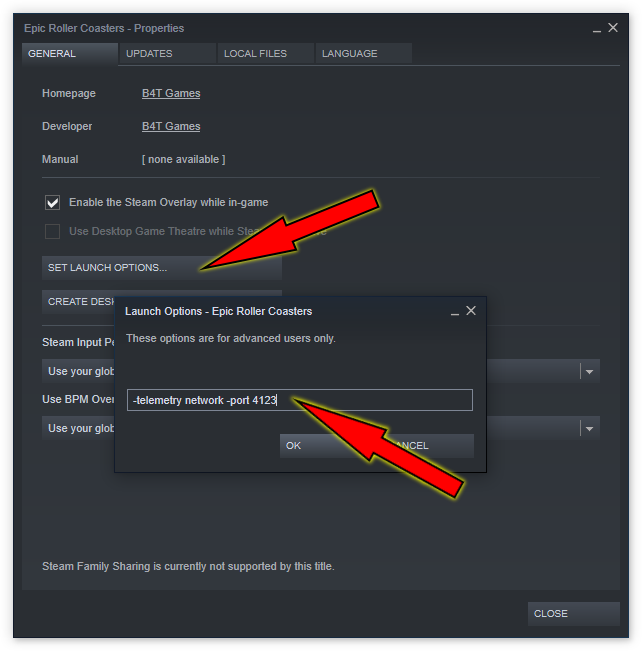

Epic Rollerecoaste - Add Telemetry Flag

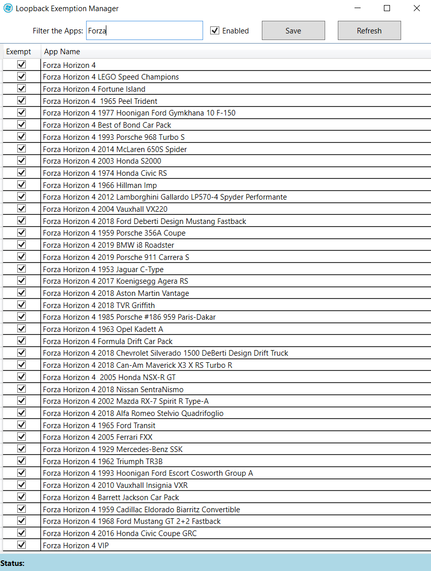

Forza 4
FH4 needs to be set up in the same way as FM7.
To enable motion the following methods can be used:
  • UDP port forwarding setup on the router
  • or; Using the loopback utility
  • or; Using an app such as Simhub or Simcommander etc, to forward the UDP
See also the Forza Motorsport thread.
There is a Loopback Exemption Manager you can use.
https://github.com/tiagonmas/Windows-Loopback-Exemption-Manager
https://cdn.discordapp.com/attachme.../557161448363655198/enableloopbackutility.exe
In Forza, Data out on. IP: 127.0.0.1 Port: 4123
Open WindowsLoopbackManager.exe as administrator.
Then enable all the loopback for all the Forza entries and save.
In the game enable data out on and ip 127.0.0.1 port 4123.

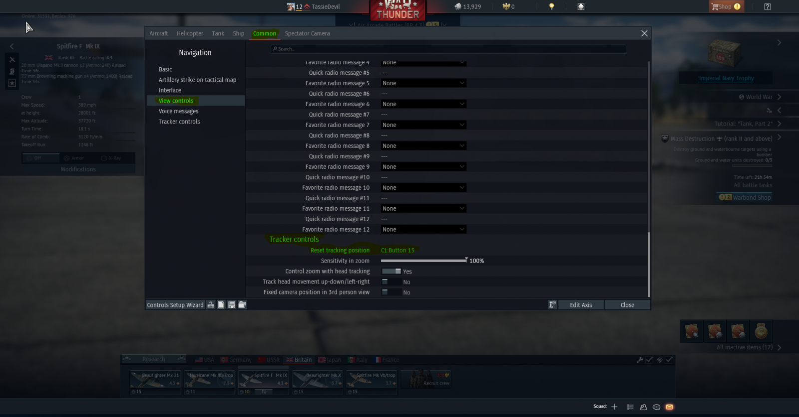

War Thunder - How to map button to recenter VR View
Codemasters F1 2018 required in-game settings
How to center VR view in War Thunder
