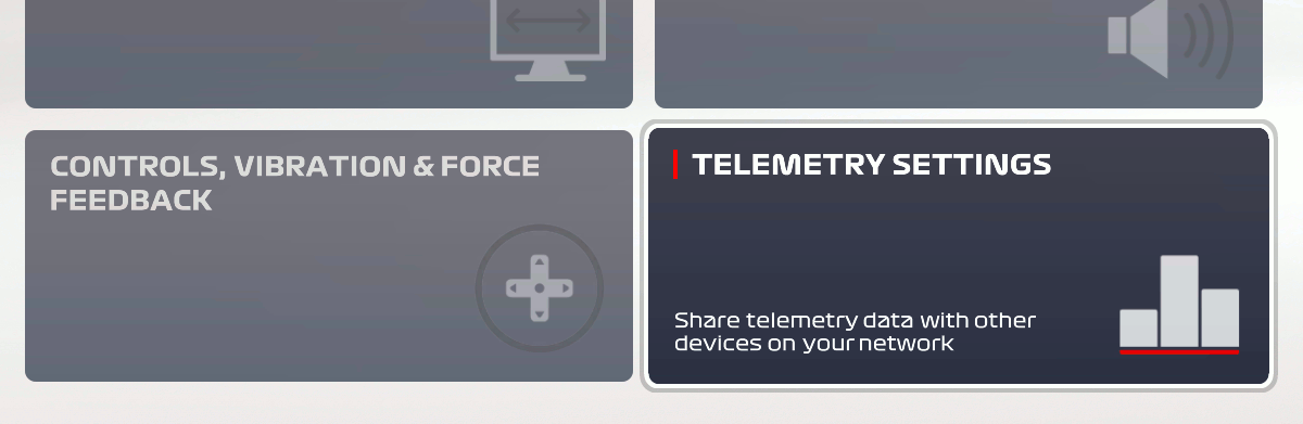

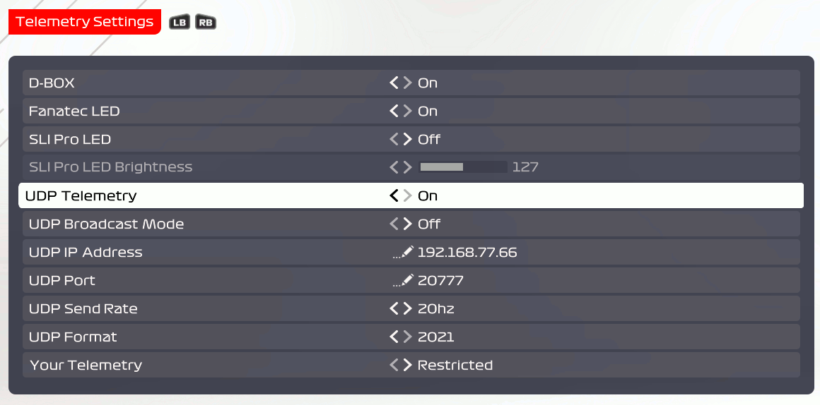

Here is @Petemnz's F1 2021 example: https://www.xsimulator.net/community/threads/f1-2021.16527/page-2#post-223054
UDP On
UDP Broadcast mode On
UDP IP address 127.0.0.1
UDP port 20778
UDP Send Rate 60Hz
UDP Format 2021
Your Telemetry Public
Used 127.0.0.1 for same pc
Ignore title it is for F1 2021

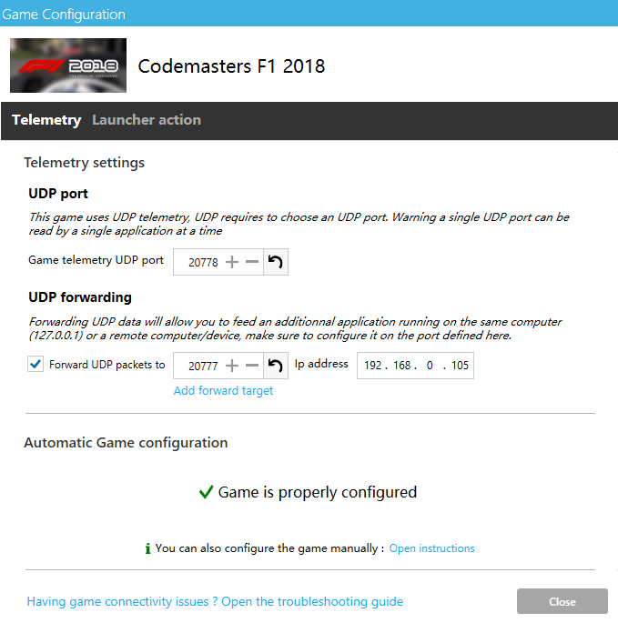

Codemaster Proxy server - Manage SimTools & Game ports
@prodigy recommends using Codemasters Proxy Server: http://www.xsimulator.net/community/threads/codemasters-dirt-rally-plugin.6823/page-10#post-92992
That way you can add multiple ports where you want the data.
http://www.eksimracing.com/cmps/

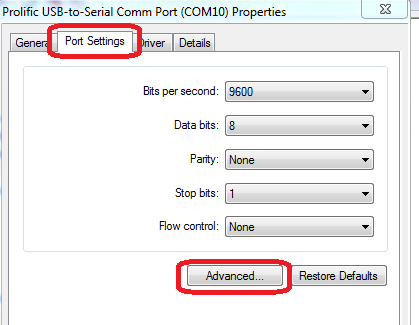

How to change the COM port
Start by going to the Device Manager. Once there do the following:
Expand the Ports ‘(COM& LPT)’
You should be looking at something like this:
As you can see Windows has set the port to COM10. However many legacy applications expect the port to be between 1-4. Let’s change that:
Right click on the device and click on ‘Properties’.
Click on ‘Port Settings’. Then click on ‘Advanced…’.
Once you’re in ‘Advanced Settings for COM10’ on the bottom you can see the ‘COM Port Number: COM10’. Click on that to change it to the lowest possible number (between 1-4).
Then click ‘OK’ on all open Property Windows.
Now the device should look like this:
from http://plugable.com/2011/07/04/how-to-change-the-com-port-for-a-usb-serial-adapter-on-windows-7
