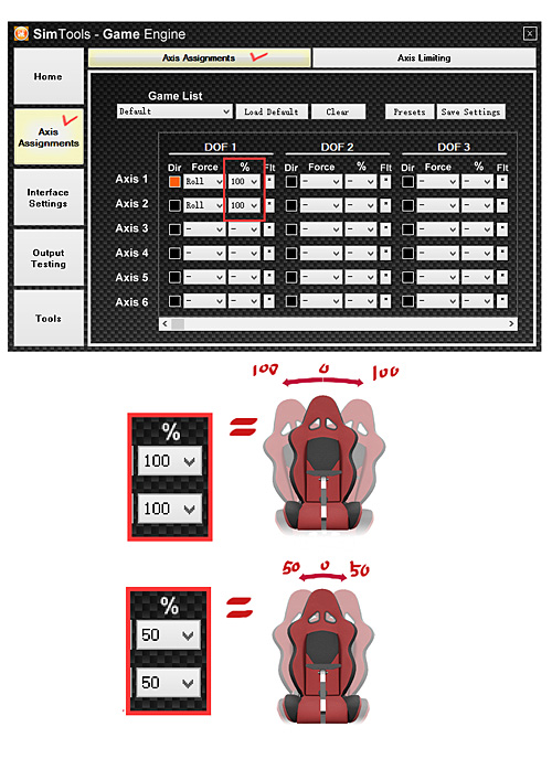

For racing select a mid range car and a reasonably accurate track, say Monza in AC, do a base profile, test it on some other tracks to fine tune, then tweak in Game Manager profiles. That way you have a reasonable range to tune harsher or softer in Game Manager profiles. Start with surge only, allocate 20% in the Axis Assignments. The actual Axis % needed for each axis depends on the design of the simulator and what force is being tuned and takes some experimentation to find and refine. In many respects total Axis allocation % is a bit like clipping in FFB settings, too much and you lose detail. Then do sway next, heave, then roll and pitch, one axis at a time.
Total axis allocation should be around 100% for race profiles, it can be a little over but do avoid huge allocations on axis that serve multiple DOF/forces, as clipping is likely: https://www.xsimulator.net/communit...-loss-moving-while-stopped.10397/#post-135974
Total axis allocation for general aviation flight profiles can be closer to 80-90% of both the available roll and pitch axis, as it is unlikely both will be at their extreme range at the same time. But be a bit more conservative in axis allocation for acrobatic and combat profiles that do use extreme maneuvers.
For flight profiles start with roll and pitch, or where supported by the plugin you can use Extra 1 and 2 in place of pitch and roll, as the later invert from one axis extreme to the other at 180 degree in-game inversion. You will also likely need to use the washout, gain and return filters for best flight effect.

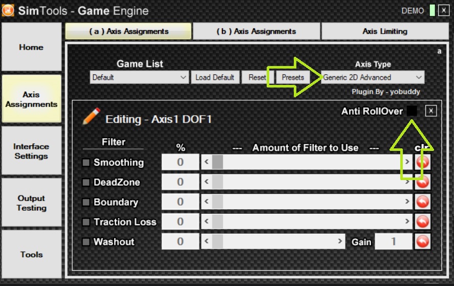

If you do use Pitch and Roll in Axis Assignments make sure Axis Type is Advanced and in the FLT box of Roll and Pitch use the Anti-Rollover checkbox. Anti RollOver is designed to eliminate the 180 degree in-game inversion in rolls and loops. This setting returns the output value to zero when the input is at its max or min setting. For Instance, if we had a Max and a Min of 180°/-180° for an input and this setting was on, any values after 90° start counting back to zero. Making an input of 100° = 80°, 120° = 60°, and 180° = 0°. The same thing happens for the negative values also meaning that a -180° = 0°. (Note: This setting is only intended for the Roll and Pitch inputs from a game.): https://www.xsimulator.net/community/threads/simtools-v2-3-is-out.12483/#post-163409

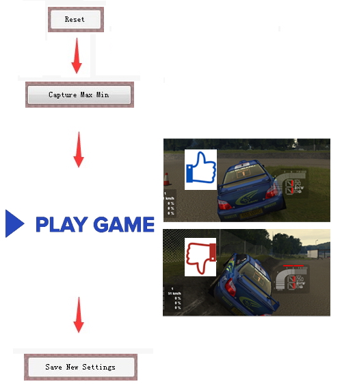

Next, you capture base settings for the Tuning Center: http://www.xsimulator.net/community/faq/set-base-tuning-motion-values-in-the-tuning-center.122/
From there manually tweak the settings. Raising the Tuning Center values will soften the motion over a greater axis movement, lowering the value will do the reverse. See here for an expanded explanation: https://www.xsimulator.net/community/threads/graphic-simtools-parameter-adjustment.9054/#post-113925
Test surge in game and manually adjust Tuning Center Values until surge feels right: http://www.xsimulator.net/community/faq/tuning-center-entering-manual-values.210/
With surge the Max value is generally smaller than the Min value in the Tuning Center, to give the effect of a snappy gear changes: http://www.xsimulator.net/community/faq/snappy-gear-change-motion.121/
Temporarily disable surge by setting is allocation to - (which effectively means none), that leaves the Axis Allocation % in place so you can easily re-enable it.

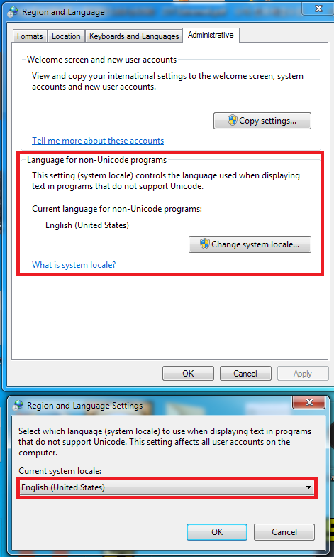

SimTools Language setting bug - Change to English Local

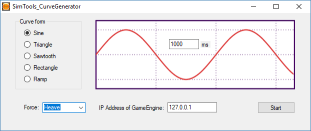

Sinusoid Generator
A curve plugin by @value1 to output a sine wave, so that you can have a programmable amplitude and frequency to exercise motors and test throws: https://www.xsimulator.net/community/threads/output-a-sinusoid.10283/#post-132905
• Drag'n'drop the zip file into the SimTools_PluginUpdater.exe as usual
• Run GameManager in admin mode
• Patch the "game" (select SimTools installation directory; that's also the reason, why you need to run GameManager in admin mode when patching)
• Start GameEngine
• Run SimTools_CurveGenerator.exe from the SimTools installation directory
• Select the type of curve you want, select the simulated force, the IP address of GameEngine (127.0.0.1 if you run in single PC configuration) and press start.

Anti Rollover
Anti-Rollover - This setting returns the output value to zero when the input is at its max or min setting.For Instance, if we had a Max and a Min of 180°/-180° for an input and this setting was on, any values after 90° start counting back to zero. Making an input of 100° = 80°, 120° = 60°, and 180° = 0°. The same thing happens for the negative values also meaning that a -180° = 0°. (Note: This setting is only intended for the Roll and Pitch inputs from a game.): https://www.xsimulator.net/communit...mulator-–-dcs-plugin.4762/page-19#post-173000

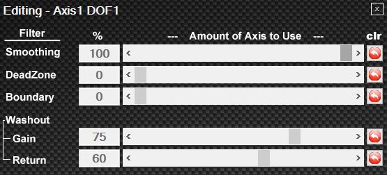

Washout - Gain and Return
A flight sim profile takes a little finesse and digging into the SimTools Filters.
One of the most useful tweaks is properly understanding and setting up Washout Gain and Return.
This is yobuddy's overview: https://www.xsimulator.net/communit...s-in-the-washout-filter-do.12224/#post-159230
(Washout) Gain – This is how much we will react to changes in the input from the game. If your simulator is not moving enough from the output from the game, Increase this value.
(Washout) Return – This is how fast we try to return to zero after a movement has occurred. If your simulator is not homing (re-centering) fast enough after a movement, Increase this value.
The Washout Filter is needed when your DOF input fails to return to center after the force is applied to the Axis.
Example: when car's rear end slides out. The Axis is left in a non centered position. If the car then needs to slide out in the same direction again, there would be no room left for the needed travel. To overcome these circumstances, we use a washout filter as to slowly move the axis back to center without the rider’s knowledge of it occurring. A Gain of 1 or above must be used for the Washout system to be considered active. A setting of 50% for both Gain and Return is a good place to start for any game.
Here is @Spit40's succinct summary of how Gain and Return function, though please note the Smoothing settings are a bit too high in his example settings: https://www.xsimulator.net/community/threads/aerofly-fs-2-plugin.9096/page-6#post-135790

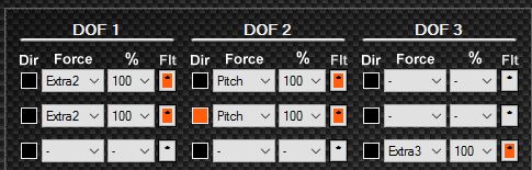

Washout Gain/Return (Updated and Corrected)
After many hours and some extra help from @yobuddy I now have a much better handle on washout gain/return and my flying feels a lot better. I really think its essential to use this properly with flight sim to get a good feeling. The problem is if you don't know quite what both gain & return do then pure experimentation can give very confusing results.
I'm mainly using this for banking mapped to the Extra2 roll/sec DOF. What I was after was a fairly responsive roll without being snatchy which would imperceptibly return to neutral once I had completed applying the roll, so that I feel the force of the roll taking effect but not the return axis movement. I'm also using it for yaw mapped to Extra3 yaw/sec. This is my current setting, though I may tweak it more now I know what's going on.
These are my main DOF mappings.
I'm finding 100% fine as I'm flying cessna's rather than fast jets, so no extreme combined DOFs.
This is the Extra2 setting.
Smoothing: I want it very smooth so 100%
Washout Gain: This determines how responsive SimTools is to the DOF input. 100% means very responsive. 1% means very unresponsive, which means changes to this DOF would have a very diluted impact. 0% means all washout functionality disabled. I'm not sure if 100% is what you get if washout is disabled, but I found 100% too snatchy for flying, in fact it seemed to undermine all that 100% smoothness. Settings around 75% seem to give the smooth responsiveness I was after when applying the roll.
Washout Return: This is all about the subtle return to neutral. Without it if I, for example, start banking to the right then hold the bank angle at 20 degrees what I feel is a strong banking force followed by an often stronger returning force once I reach 20 degrees. Very unnatural. Now once I reach 20 degrees and my roll acceleration returns to 0, the axis returns gently to neutral. It can feel a little gritty but I think I'm now hitting the limits of the motors & gearing and their ability to make smooth fine adjustments.
