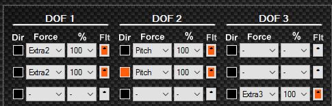

These are my main DOF mappings.
I'm finding 100% fine as I'm flying cessna's rather than fast jets, so no extreme combined DOFs.

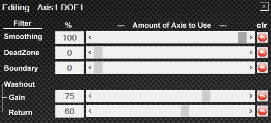

This is the Extra2 setting.
Smoothing: I want it very smooth so 100%
Washout Gain: This determines how responsive SimTools is to the DOF input. 100% means very responsive. 1% means very unresponsive, which means changes to this DOF would have a very diluted impact. 0% means all washout functionality disabled. I'm not sure if 100% is what you get if washout is disabled, but I found 100% too snatchy for flying, in fact it seemed to undermine all that 100% smoothness. Settings around 75% seem to give the smooth responsiveness I was after when applying the roll.
Washout Return: This is all about the subtle return to neutral. Without it if I, for example, start banking to the right then hold the bank angle at 20 degrees what I feel is a strong banking force followed by an often stronger returning force once I reach 20 degrees. Very unnatural. Now once I reach 20 degrees and my roll acceleration returns to 0, the axis returns gently to neutral. It can feel a little gritty but I think I'm now hitting the limits of the motors & gearing and their ability to make smooth fine adjustments.
