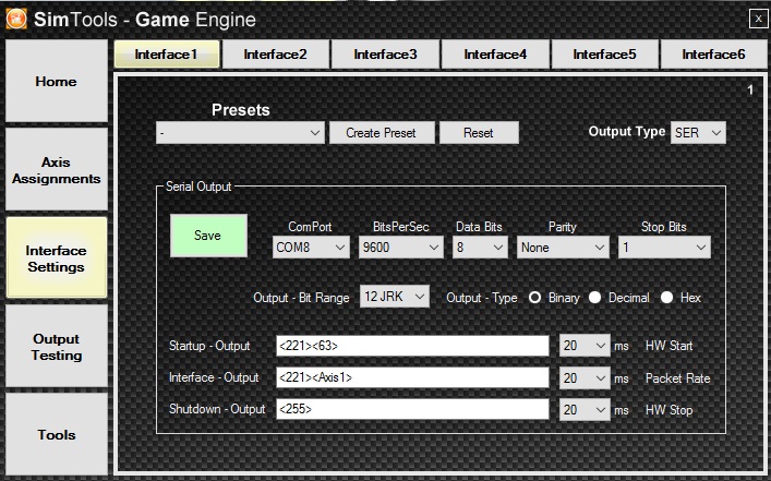

Startup and Shutdown positional controls
You can use Startup and Shutdown options to hold you sim in position when using motors that can be back driven when not powered: https://www.xsimulator.net/communit...ation-for-oculus-rift.7684/page-3#post-111568
With JRKs 221 is the on command for Position, 63 tells it where to go and 225 turns it off: https://www.xsimulator.net/communit...ght-with-oculus-rift.6179/page-14#post-106293

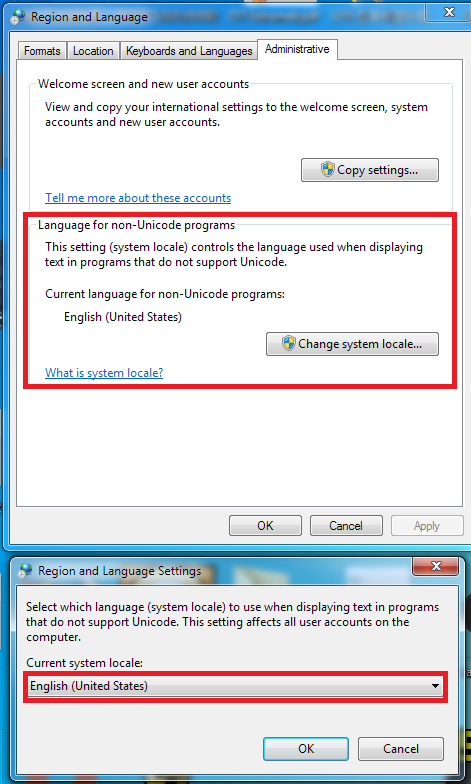

UDP games produce no output data
13956
Here is an alternate method that can use the original settings on your control panel for those who uses unicode languages to avoid language compatibility issues with other applications here.
The SimTools developer @yobuddy has advised that the output bug has been found and will be fixed in the next release of SimTools: http://www.xsimulator.net/community/threads/game-data-input-0.4909/page-2#post-50117
Thanks @jamesdio for the solution.

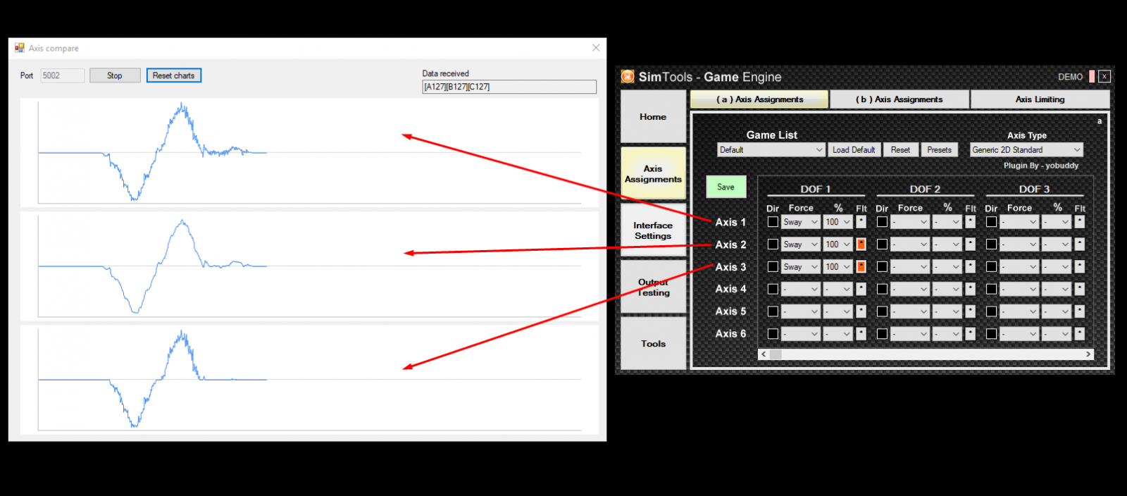

Testing SimTools without a simulator
Here is a handy tool by @perdixero which simulates the movements of a 2dof, without having hardware or needing to connect anything: https://www.xsimulator.net/community/threads/simple-application-to-analyze-the-axis-setting.10430/

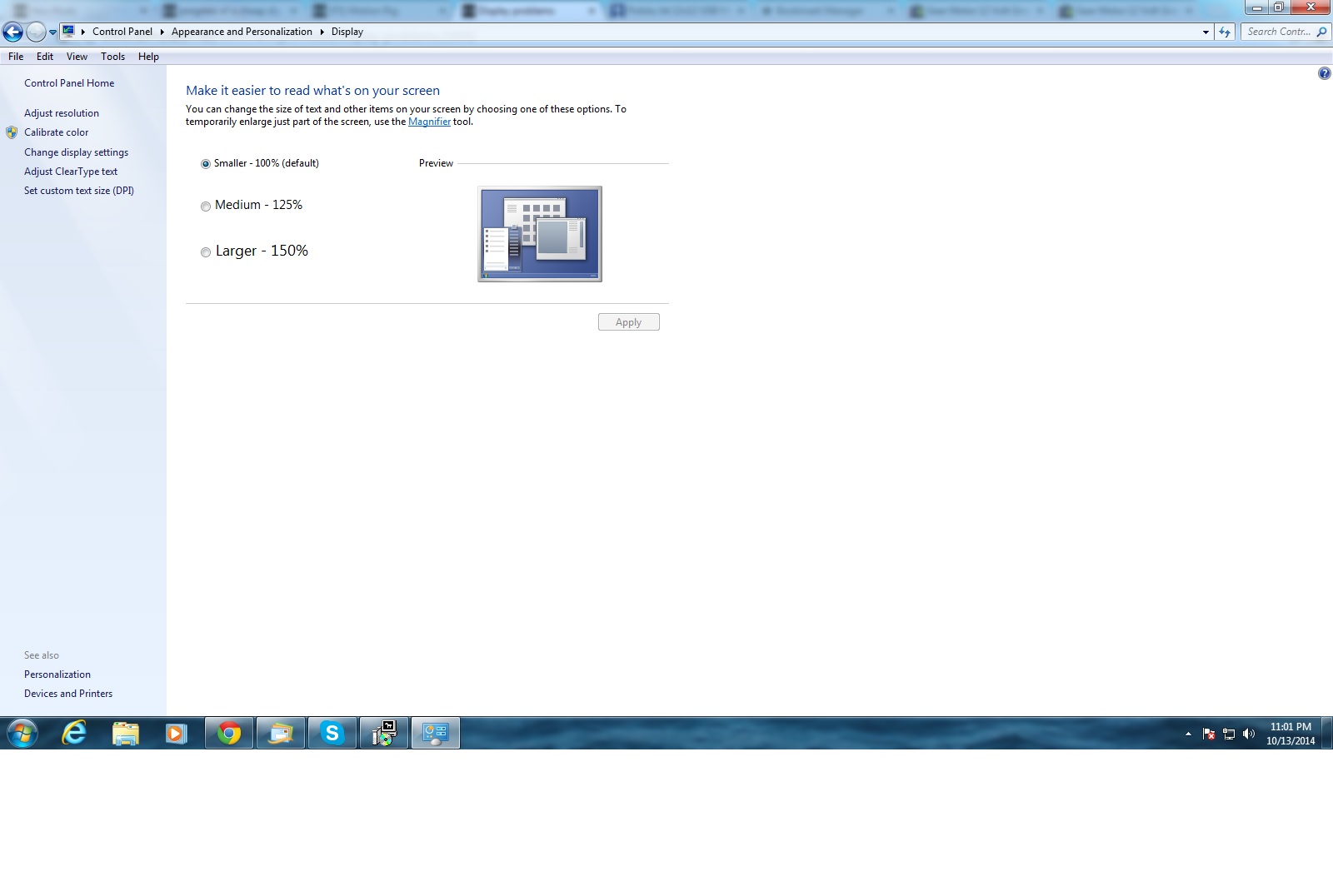

Game Manager DPI fixes
But if you have a high resolution screen, or just bad eyesight, you may not want to have your icons at 100%. Luckily @eXntrc has created a High Res hack fix for SimTools, which you can read about and download here: http://www.xsimulator.net/community/threads/user-fixed-fix-for-game-manager-dpi-issues.6086/
