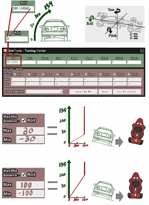

Tuning Center:
Capture Max Min:

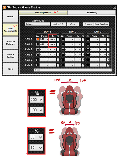

Axis Assignments:
